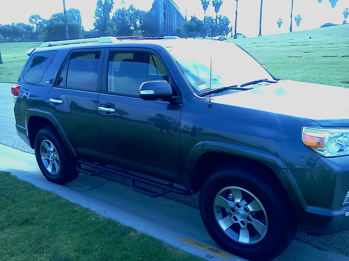

bars1.jpg~original
bars2.jpg~original

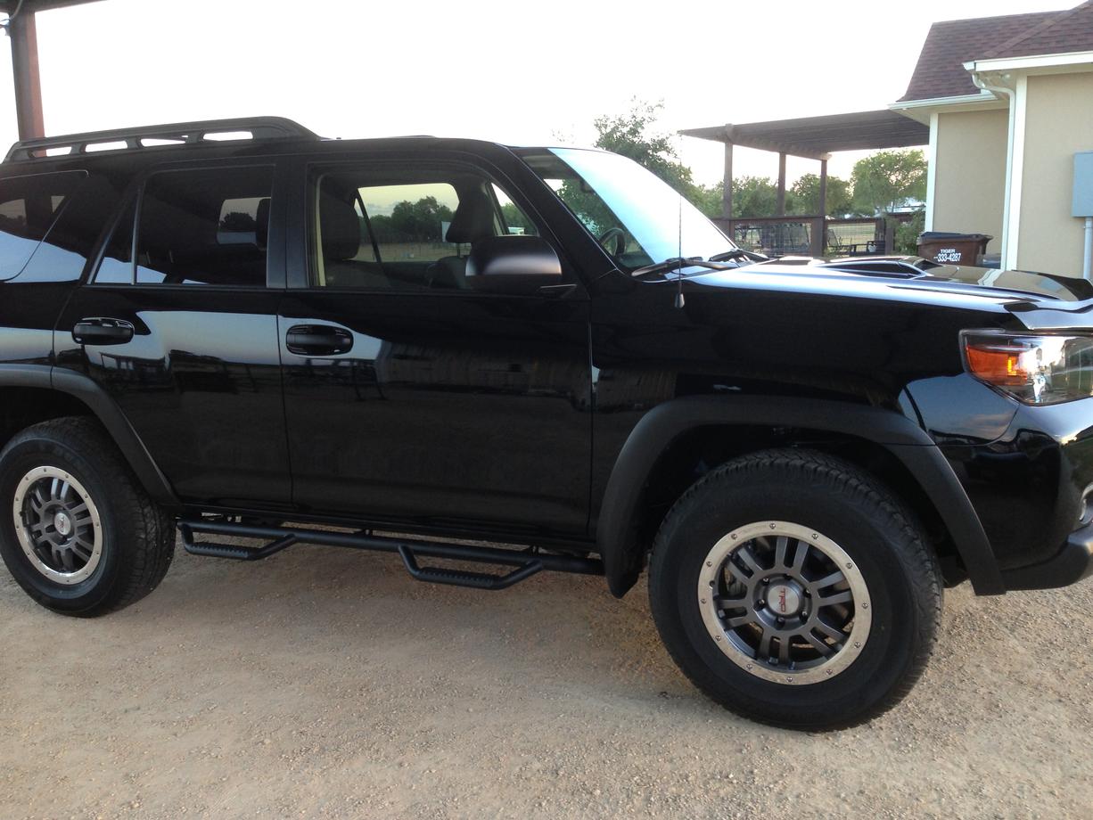

Installing Nfab step on 2013 4Runner TE
Thanks to this thread, me and my two sons installed both sides in under 30 minutes. Next week, grill guard. Thanks guys!

Thanks guys. I have a 13mm but it does nothing but slide, no grip. Bought a couple more tools, more hexagon sockets with a 13mm in it. Getting ready to try for round 2.
The factory Toyota bolts are 12mm, N-Fabs bolts are 13mm. I didn't have a torque wrench available to torque them down to the recommended amount so I used my German wrench and got them "gutentite." Jumped on them and stuff, seems to be no issues, next time I'm at work I'll fix it though.
Just installed these in under 20 minutes by myself. Very easy to do with just yourself due to the light weight of the bars. One you figure out that the directions are jacked up and backwards it's easy from there. 5 bolts on each side and you're done.
