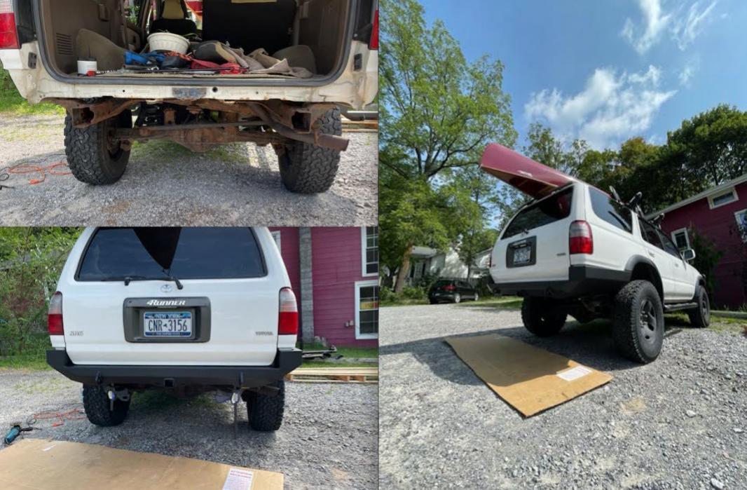

Apologies for the blatant transgression jgue467:
Most recent images I have, sorry for the booty pics.... =:D
