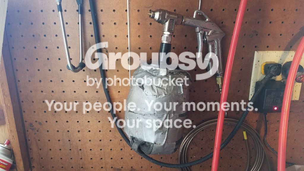

Wrap spray gun base with an old shirt and duct tape to keep the oil warm, like this:

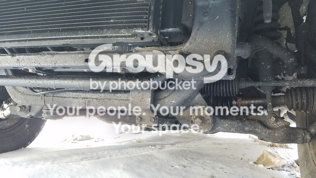

This is what my GX A arms look like two months after spraying and constantly subjected to NH salt and slush.:
Fully waterproof. You can still see runs on the crossmembers.

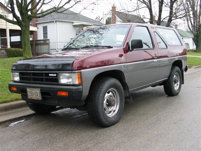

The following photo, was my 1989 Nissan Pathfinder that I sprayed annually.
- bought used and owned another 14 years
- still captured good resale value, and old body metal was rust free
- after 17 years of driving in winter (on Hwys. applied with rock salt) and SUV never garaged
PS - back in the mid 1970's / used motor oil undercoating, was the ticket.
- but dirty oil contains engine acid, on the pH scale...just saying / acid does not stop rust, in its tracks

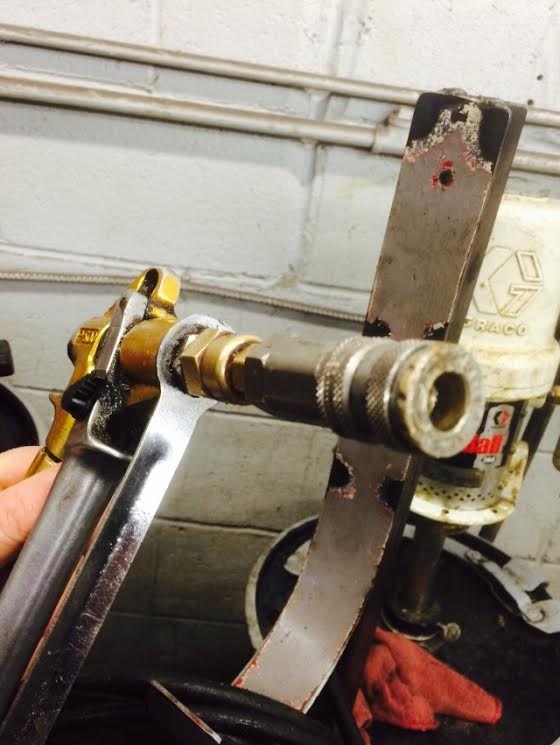

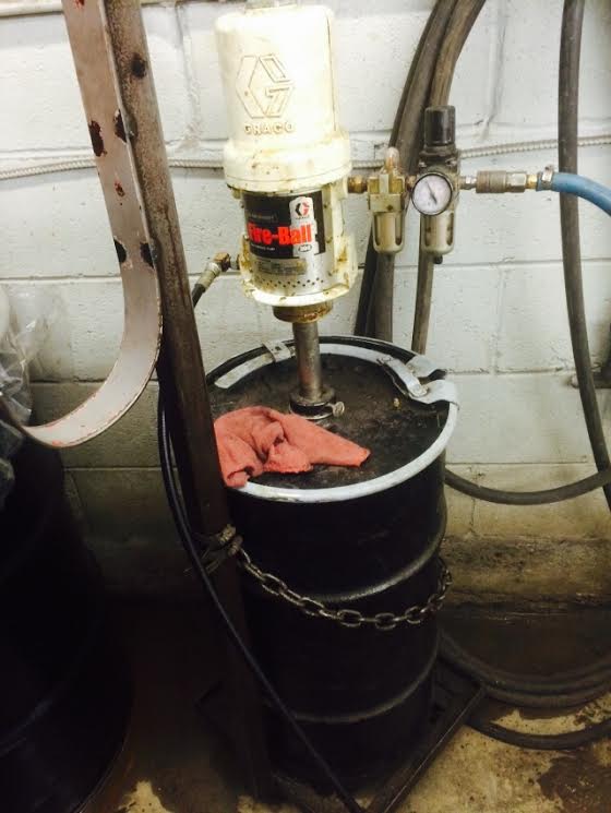

^^ The undercoat shop businesses (up here), tend to us a pneumatic 50:1 pump, to transfer wax-oils / using air pressure without the oil fog.
- this keeps T-shirt, eye glasses, vehicle interiors clean & oil out of employee lungs / vehicle windows & bay cleanup, is also minimized
Many Commercial transfer-wax oil spray systems, cost upward of $3,000.
- improves yield of oil formula (reduced waste), better hidden coverage & uniform mil thickness results
Graco Fire Ball pump: https://www.youtube.com/watch?v=ywaD4wT3hus
Spray equipment: Lemmer rust proofing spray equipment | corrosion control | corrosion inhibitor | rust inhibitor | undercoating | sound barrier

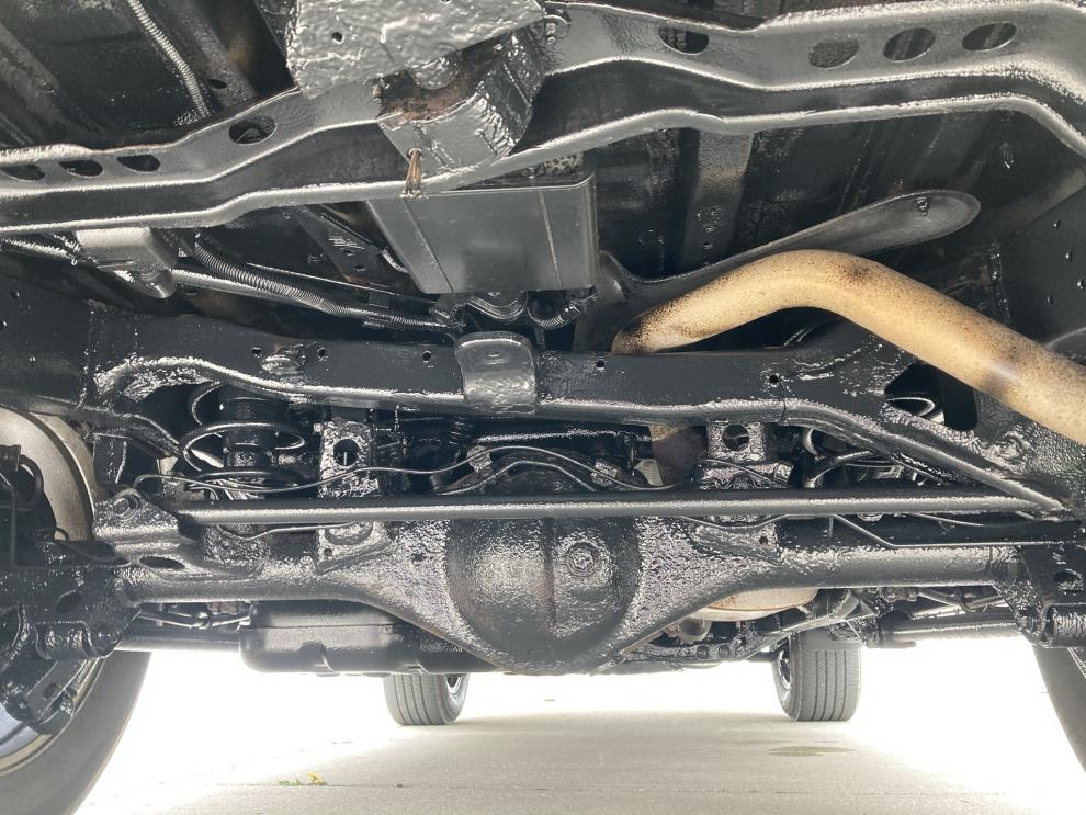

3 winter update on this - these pics were from mid-winter, you can still see solid waxy-oil runs on the frame
More of a waxy grime on the crossmember and trans lines but still 100% waterproof and rust-free
Replaced this CV, I believe after I undercoated, or maybe it just flung the oil off, can't remember time frame. Either way, you can see what the whole undercarriage would look like without being sprayed for comparison
By the end of this winter there are a coule bare spots that are just starting to get some surface rust on the bottom of my front diff, so going to touch that and a few areas that I can see I missed in the engine bay as well. Still lloking better after 3 winters than Fluid Film or plain B&C did after 3 weeks, worth it to me.
