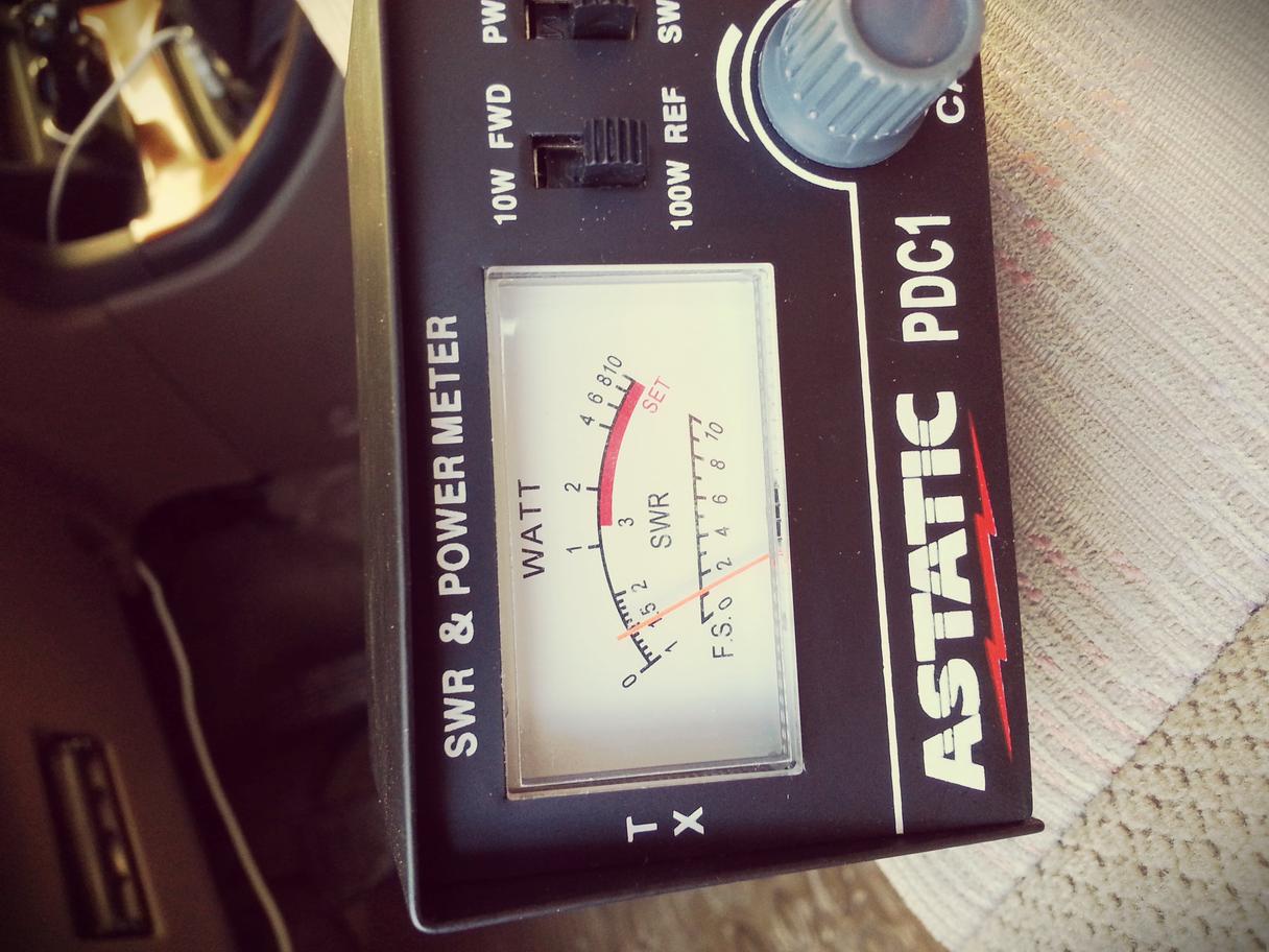

All tuned up! 1.7 on ch 1 and 1.5 on ch 40. Ill need to tune again in a more open area when I get the chance. This is a 4 foot hatch mounted firestik with a Cobra 75 wx st. Pretty standard.
