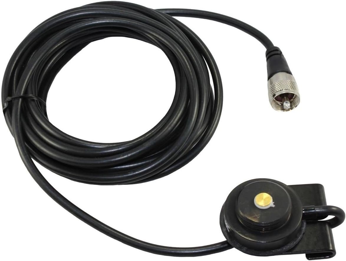

I am currently using a TRAM universal lip mount which works but due to the curves of the T4R hood it doesn't sit flush and rather angled.
Amazon.com: New Tram Browning Black 1246-B Trunk Antenna Mount NMO With PL-259 connector and 17Ft of RG-58 Coax Cable: Home Audio & Theater

Where is your Tram mounted? Mine is on the back edge of the hood and while not a perfect fit to hood contour it's good enough, especially for $20. Bend the antenna slightly so it is perfectly vertical and I think it looks just fine.
Shown without antenna with rain cap in place.
My TRAM mount is in the same location as MeefZah
