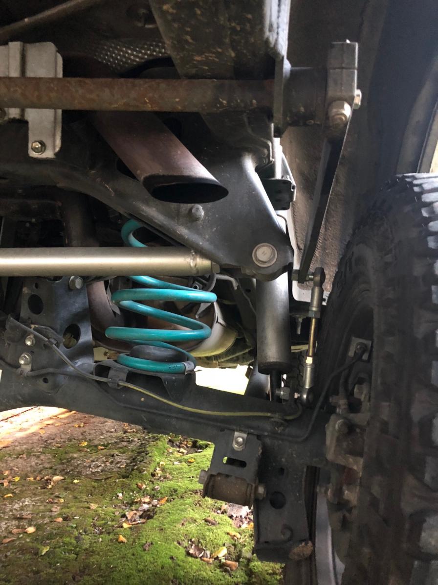

[MENTION=96425]JSparky[/MENTION] has put the Anti-Rock kit in the rear of his 4Runner and [MENTION=124732]LawnDart[/MENTION] was the first to put one in. There may be a few others, so it is doable.
Lawndart used an anti-rock rear when he was still running around these parts. You can check out his build thread for that.
