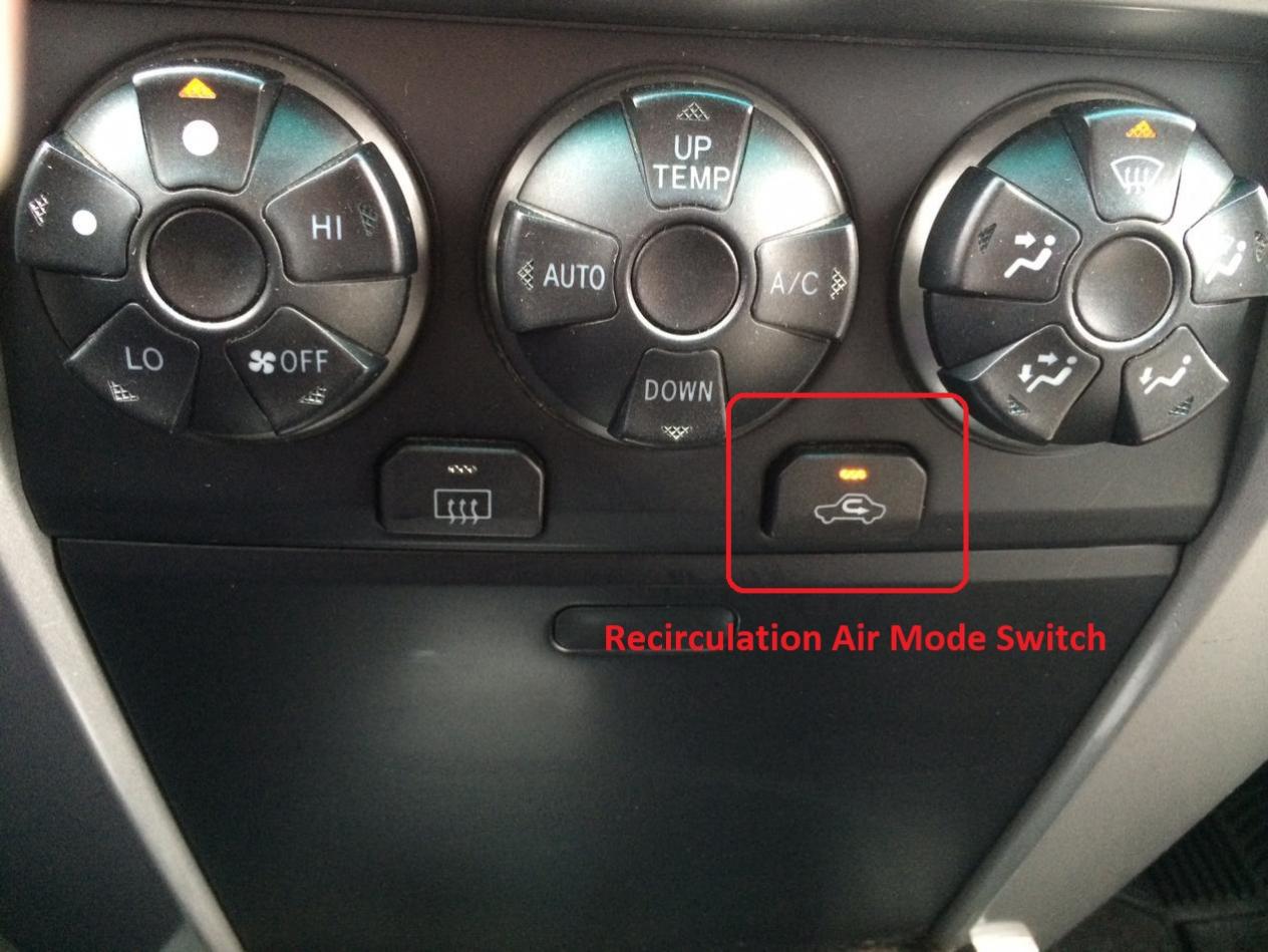

How do you check to see if the car is in recirculation mode?
I'm replacing a rusted header soon and I think the ECU needs to be reset because of the oxygen sensor so I want to make sure I can get that setting right each time.
If the light is on, then the vehicle is recirculating air inside of the cabin, if it's off you're in fresh air mode. That's assuming the recirculation air door is working properly though.
