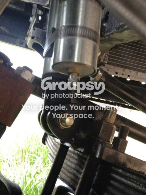

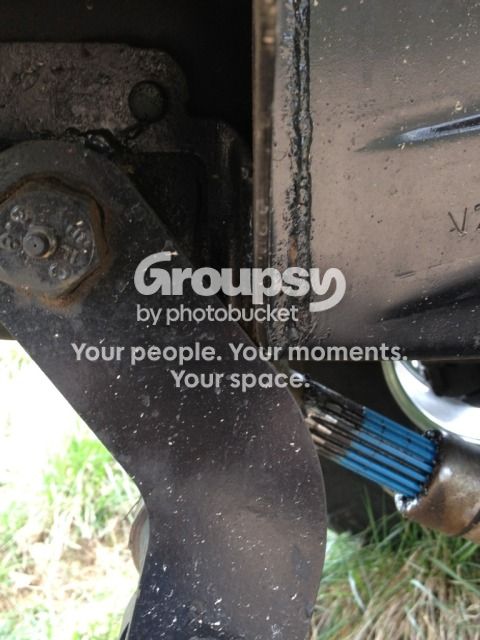

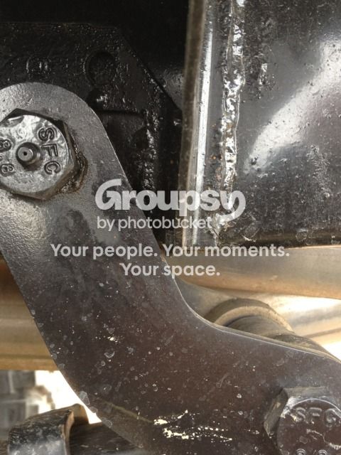

Some problems i ran into
e8315e7a.jpg~original
e335735d.jpg~original
19220170.jpg~original
It can go more if i trimmed the body mount pockets and put some 10" travel shocks or moved the shock hoop. The rear is getting bound up by the traction bars, just need to sleeve the tubes on the bars so they flex without binding.
