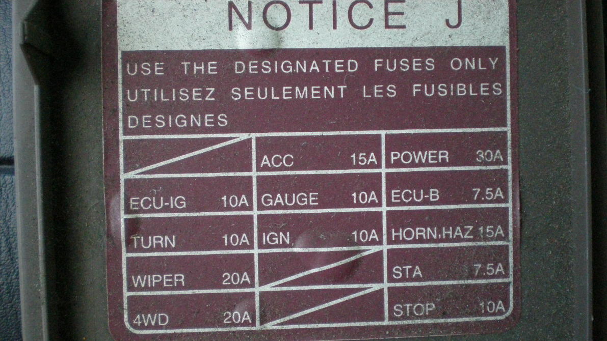

here's a pic since I already took it anyway

You've got a fuse panel on the left side of your dash in front of your left knee. Check to see which one says 'ACC'. That's the radio. 15A
man that sure was the one burned to the root, when to toyota and got the fuse everything works now, nowi can listen to my lady gaga in peace. jk only rock metal blues hiphop rap techno allowed in my car.
