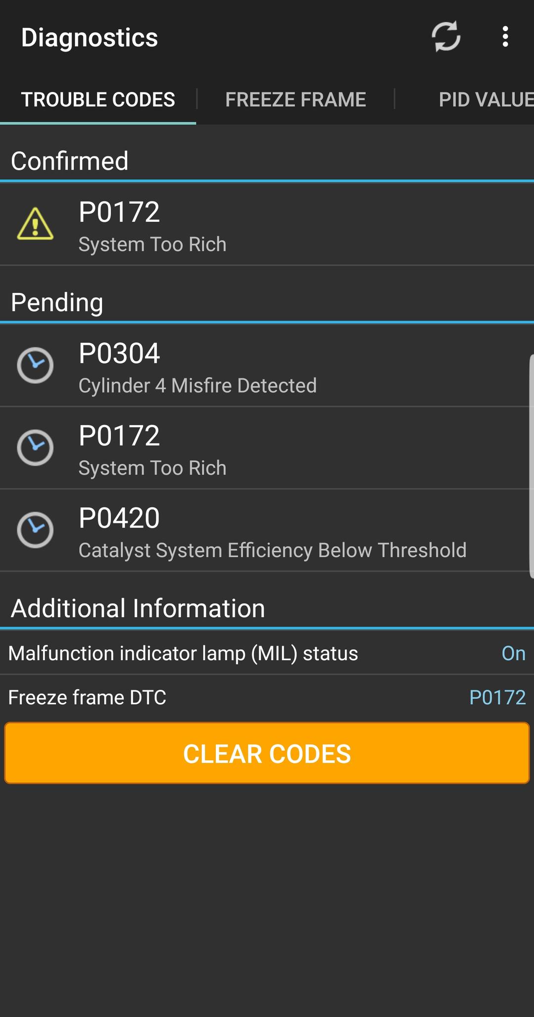

This was from when I first had the issue:
attachment.php
My truck idles very smoothly. Starts up just fine...Just not drivable after that.
What do you all think?

your readings indicate rich conditions,-19 is rich. your o2 sensors are fluctuating between 0.1 to 0.9 volts which is inline.you also have a system to rich cel. system to rich can be caused by dlirty or bad maf, leaking injectors, faulty fuel pressure, coolant temp sensor, exhaust leaks also camshaft timing or low compression issues like a cracked head or bad HG etc. among other things.
