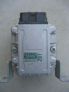

Did you replace the Coil Igniter also?
I had this same exact thing happen to my Toyota 3VZE V6.
I was just driving along and my truck just died. I had my rig towed to my mechanics and I describe him what happened and his first thought was the Coil igniter. He check the coil and that was ok, but no spark. He had a similar thing happen with a Toyota early that week.
Hope that helps..
Hope that helps..
I replaced the igniter and still no spark? I am going to go back and check the
dirtibutor and see what happens. May be I installed the replacement incorectly?
