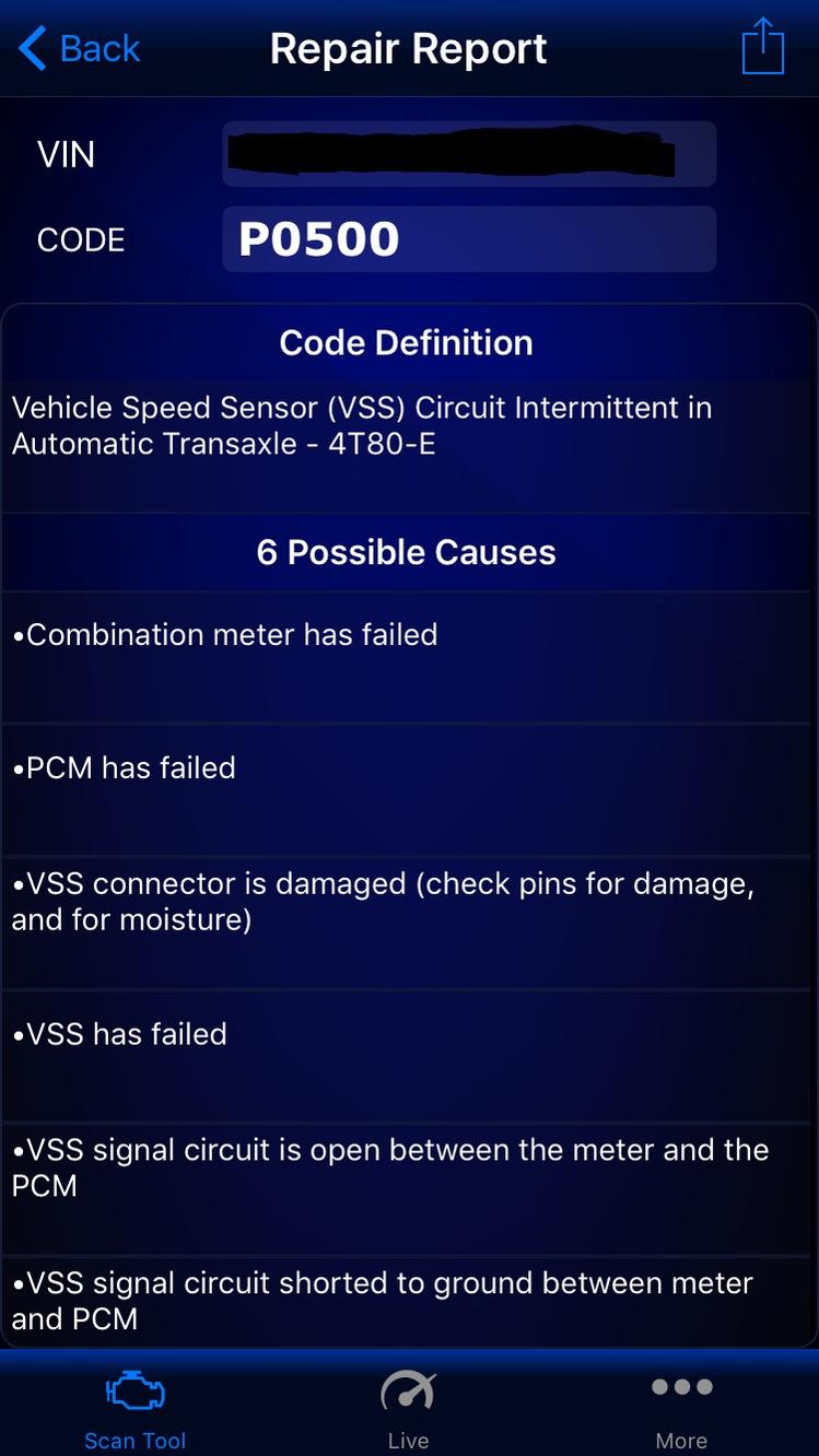

Then, about a minute later, I realized my speedo stopped working. I stopped, turned the engine off, started her back up. Check engine light came on and threw a P0500. Still speedo isn't working.

Check the VSS wire from the Skid Control ECU to the the combination meter.
Vehicle speed is collected via the wheel speed sensors, smoothed and converted into a single square wave, which is then output to the combination meter for the speedometer and then relayed to the ECM. I'm guessing the issue is between the skid control ECU and CM since the speedometer isn't registering.

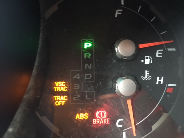

I still have the annoying Christmas tree dash. I know I need to do another brake bleeding to clear my "BRAKE!" (and possibly the ABS) dash light, but why wouldn't my VSC on/off lights not clear?

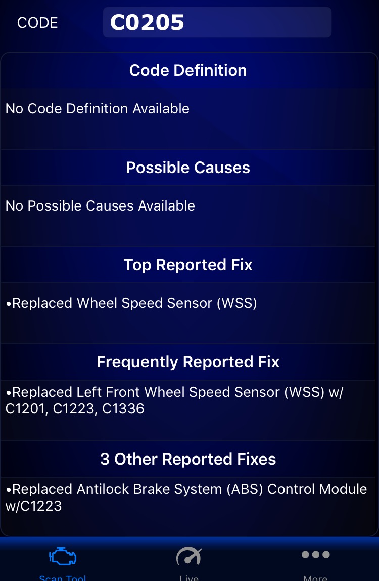

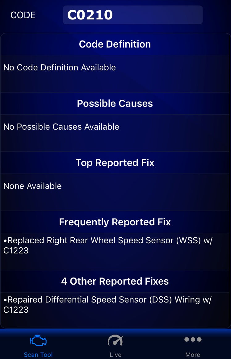

Your scantool doesn't do non-OBDII DTCs I am guessing. You should see a multitude of "C" codes stored if those lights are on.
I do [MENTION=66389]BlackWorksInc[/MENTION], a whole host of them :lol:

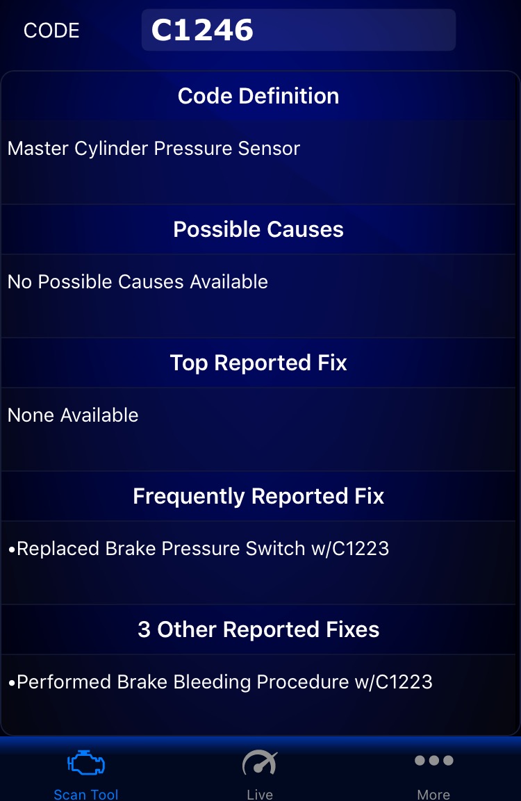

C1246 - This one I should be able to fix with a brake bleeding.

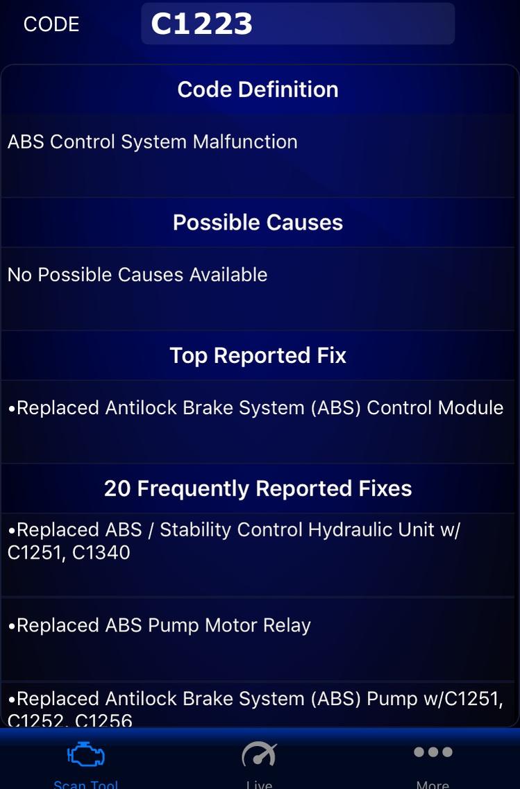

C1223 - I hope this goes away with the brake bleeding as well
C0210 & C0205 - I may have damaged the wiring or sensors during my lift and or brake/rotor replacement. Any ideas on a quick fix? or do I need to replace wiring/sensors?
