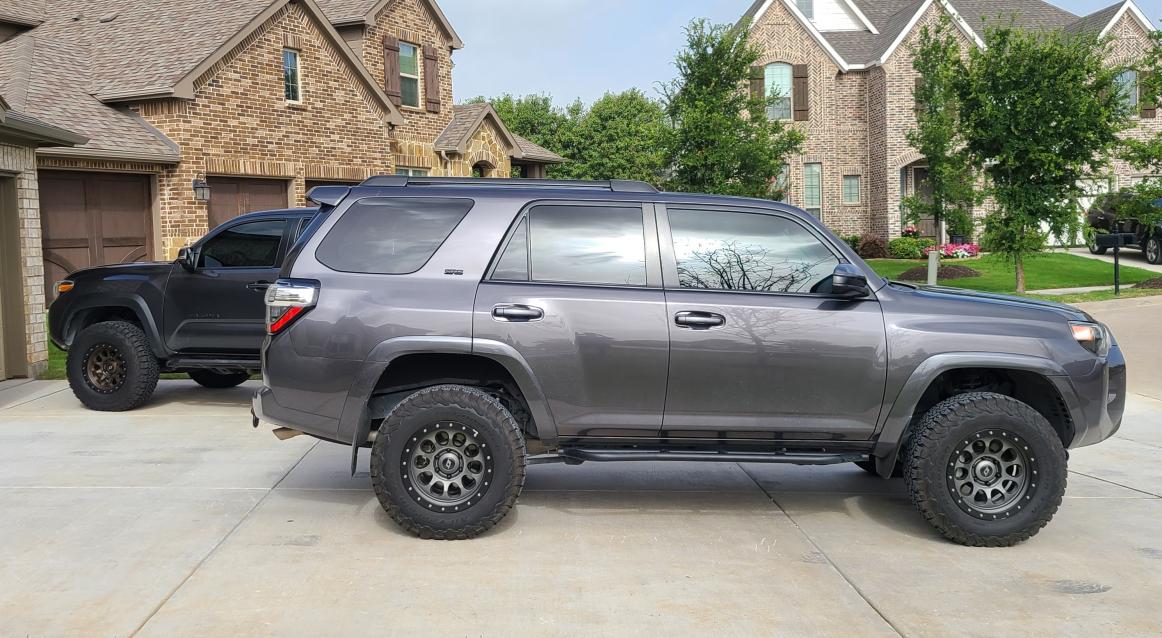

I did the no spring compressor method. 2 leasure hours this morning. Set the bilstien 5100 from 1.7 to 2.5 perch
Front: 37" measured from ground to fender well.
Bilstien 5100 set at max 2.5 stock coils
Rear: 38.25" measured from ground to fender well.
Bilstien 5100, with bilstien 1.5 rear coils (part# 36-281817), and OME correct rear lean trip packer 0.4 (10mm).
