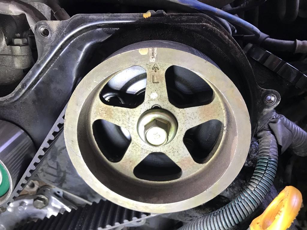

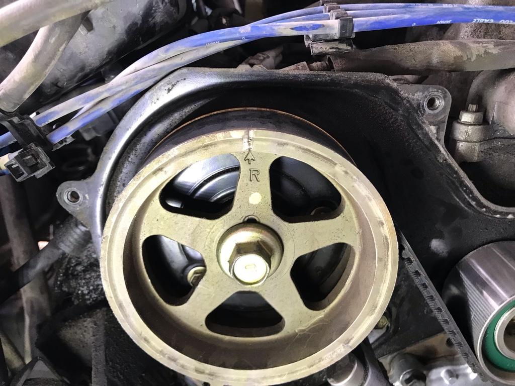

Turned the cam 4 times all appear to be still lining up.

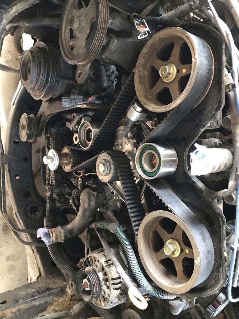

Anything look off? Yes I know there’s a ton of gunk. Was there when I bought it and I really don’t plan on cleaning it
Anything look off? Yes I know there’s a ton of gunk. Was there when I bought it and I really don’t plan on cleaning it Sent from my iPhone using Tapatalk[/QUOTE said:

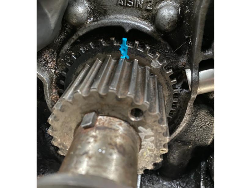

Every thing looks good except I don't see the dimple on the crank sprocket. I can see the paint mark lined up correctly. Could be an after market sprocket.
I don’t see it either. And no key in view. Even aftermarket the key should be visible.
There should be a dimple on the reluctor wheel on the engine side of the crankshaft timing gear. That dimple is your timing mark for the crankshaft timing gear.
Hmmm I’ll see if I can find it. I was not aware of the dimple
The key is Just visible at ~7-oclock, the corner is just peaking out behind the washer. My personal photos aren't very good, but it sure looks like the dimple is the 2nd spline clockwise of the key, which matches Spartacus's photo.

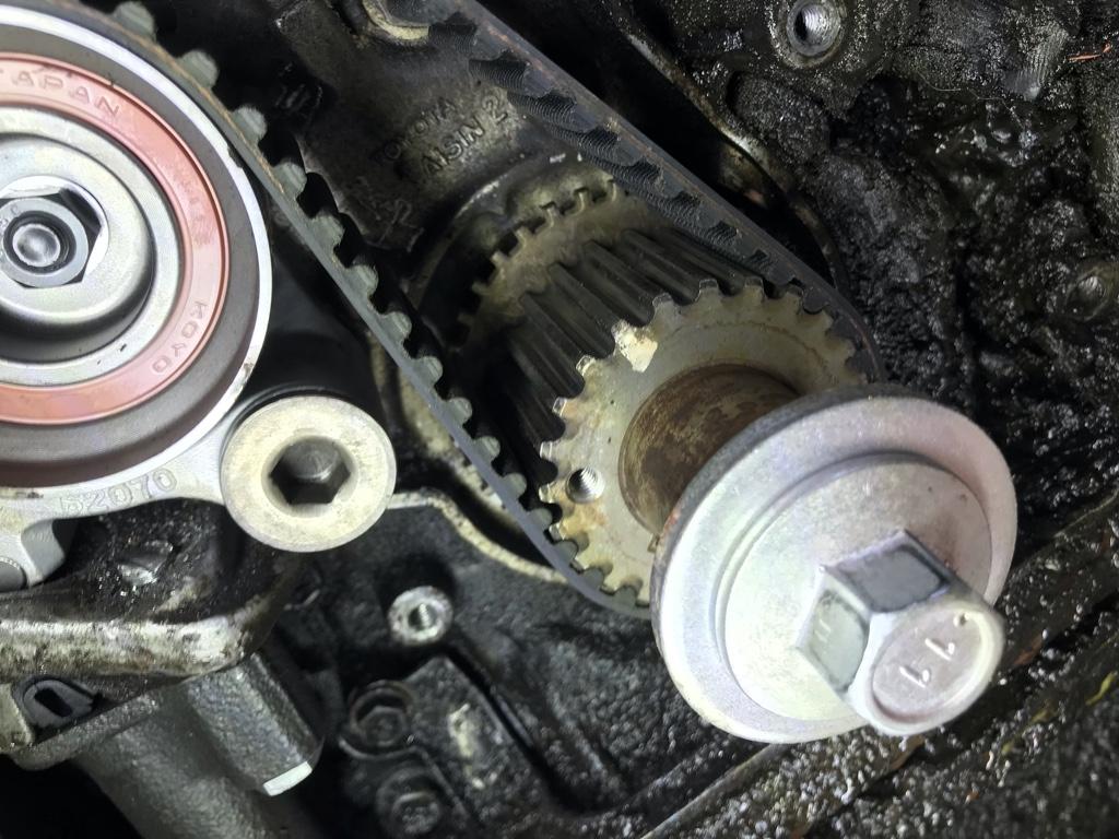

You'll have to take the tensioner off. Reload it in a vise with the pin or Allen wrench or you can use a Schley (SCH97300). Set timing again wth the crank shaft sprocket mark dimple like my pic. There is also a notch mark on the harmonic Balancer that lines up with the 0 timing mark. Also the two revolution double check should have the cam and cranks mark line up but the marks on the belt will be off.
I’m pretty sure this was the problem. Thanks guy. The only thing that stands in front of me now is a broke tensioner bolt.
