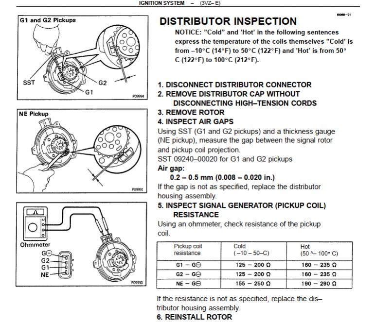

4. INSPECT PRIMARY COIL RESISTANCE
Using an ohmmeter, measure the resistance between
the positive (+) and negative (–) terminals.
Primary coil resistance (Cold):
0.36–0.55
Primary coil resistance (Hot):
0.45–0.660
If the resistance is not as specified, replace the igni–
tion coil
5. INSPECT SECONDARY COIL RESISTANCE
the positive (+) terminal and high–tension terminal.
Secondary coil resistance (Cold):
9.0 – 15.4 k
Secondary coil resistance (Hot):
11.4 – 18.1 k
tion coil.
Distributor check is attached as image. There's also a whole section (pages, too long, not copied) about the plug wires, which can lead to coil failure. Not mentioned here in the FSM is the "tap" test for testing the igniter. I can't remember how to do it off the top of my head, Google should know though.

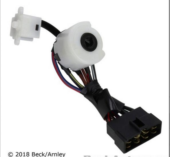

Without refreshing what the problem is I would like to know if anyone can tell on 1990 Toyota 4Runner 3VZE, 3.0L,V6, where is the location of the Ignition Switch Relay (not the ignition Switch itself and not the Starter Relay). I thought it would be located somewhere at the end of steering column inside the car but, I don’t see anything looking like the Ignition Switch Relay my search produces for my 4Runner and shown in the image here. Thank you!
