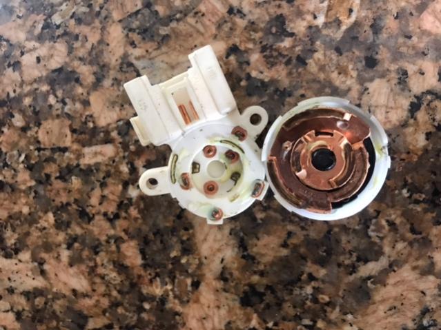

cleaned up wire harness, took some voltages again, getting power everywhere except at the starter plug when you go to turn the key. im reading 14v everywhere except for there.
well after diagnosing no power to the starter connector with my mom bumping the key, i moved on to the ignition switch, upon removal low and behold hopefully found my problem. the corner of it was popping up when i took it off, went to push it back together and it broke into pieces. so ordered a new one from rockauto and hopefully that was the issue.
Well done mate, excellent diagnosis skills I would never have found that :noidea:

well the ignition switch did absolutely nothing, started with the multimeter again and this time when i turn the key i'm getting power at the starter lead plug. so i'm assuming the starter was messed up to begin with as well.
