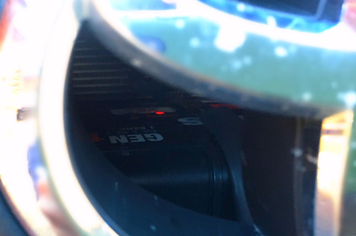

I went with the noco 4amp mini. It's pretty small and tops up the battery perfectly as I rarely drive the truck. I just plug it in once a week overnight and it completes the charge cycle in about 12 hours. Here's my mounting location, so far has not been in the way.

I'm still happy with my NOCO 4A, I've got mine mounted to the top of the fuse box.

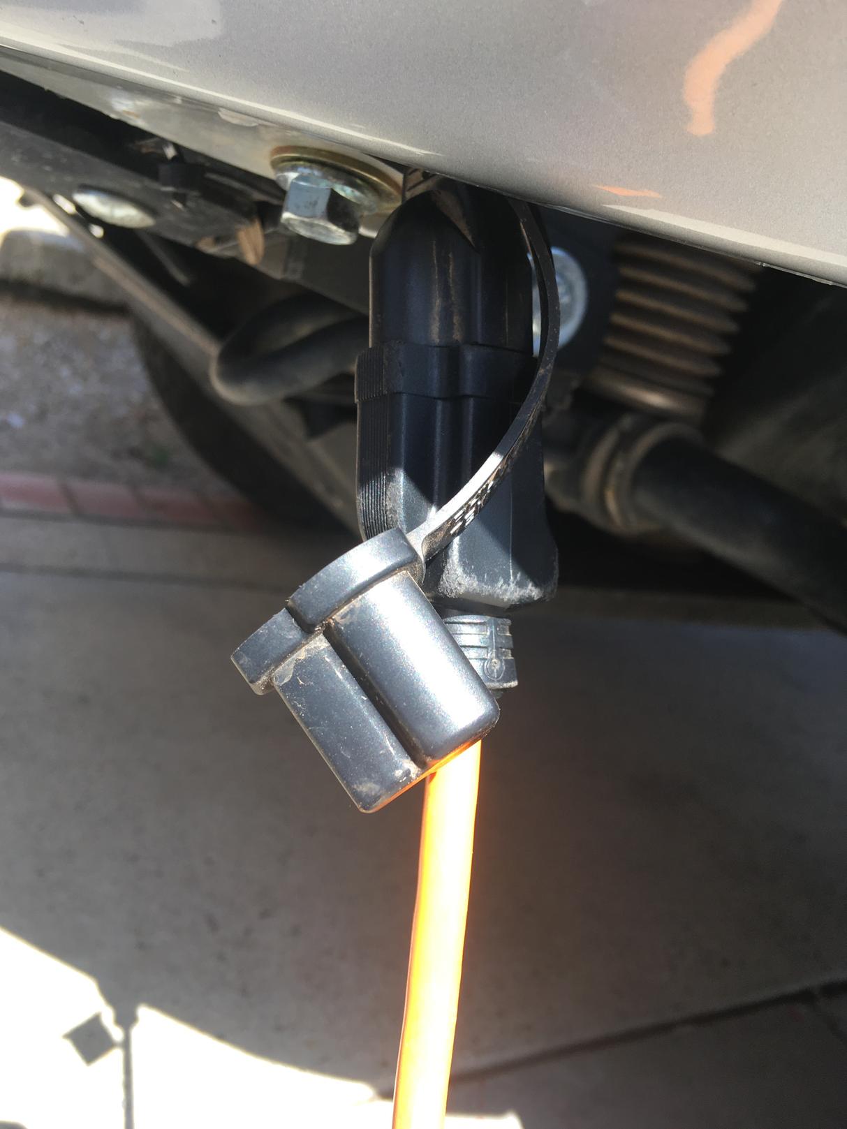

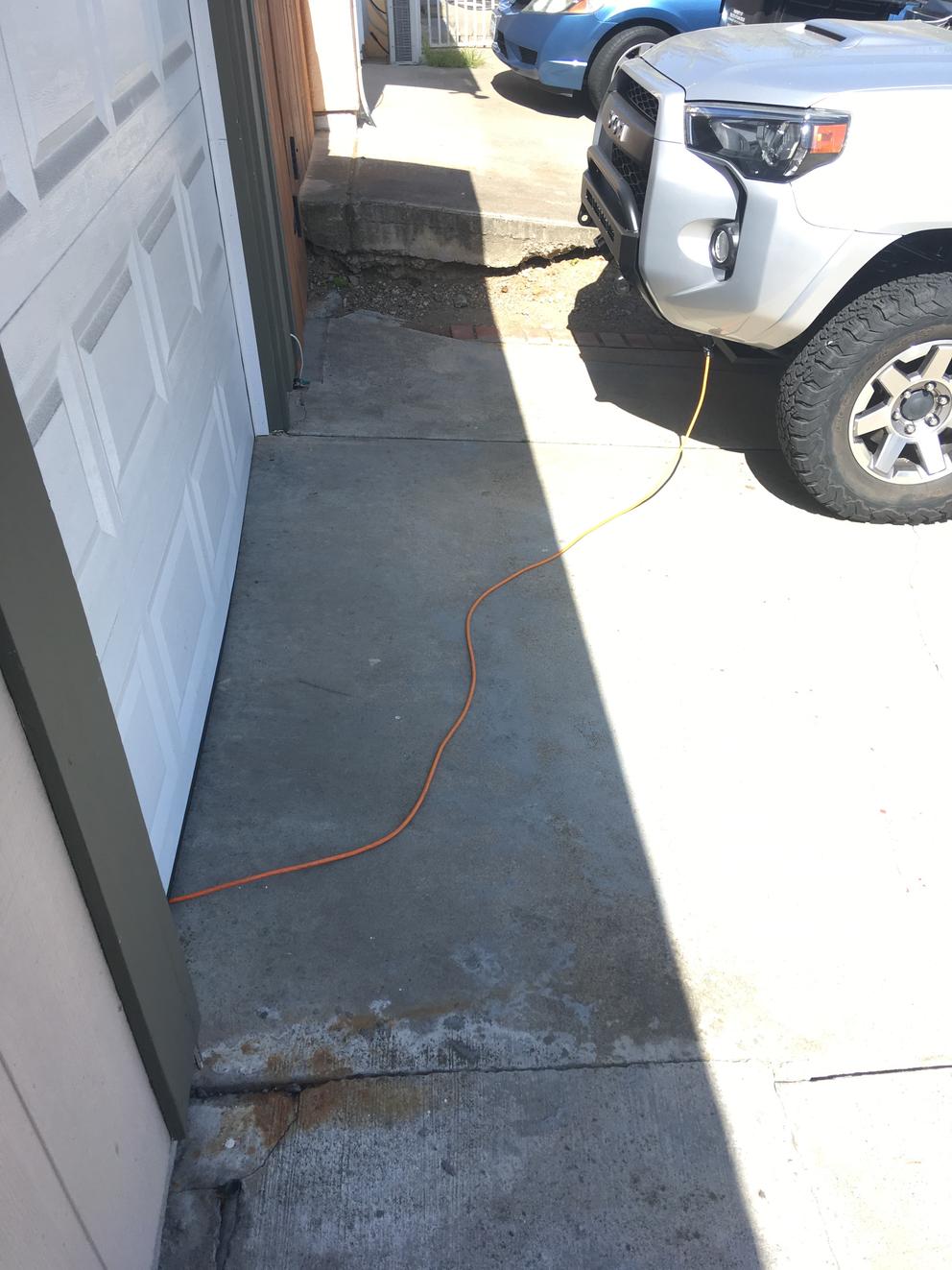

I run the plug under the garage door and to the charger plug. I routed mine out the bottom and it lays nicely inside the bumper when not in use. Put a terminal cover originally meant for engine block heater to keep it clean.
