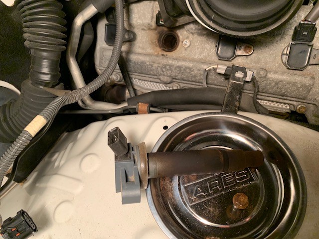

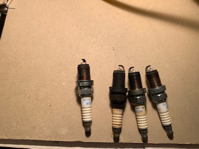

Hi all, long time lurker, first time poster. I can't create a new thread yet, so I figured I'd piggyback onto this spark plug thread. I replaced the plugs in my '05 V8 last weekend with Denso Iridium plugs. First time changing plugs but it was super easy thanks to a few tips I gleaned from here.
All was well until I got to the next to last plug on the passenger side. Electrode and tip looked normal, wasn't wet, but it was covered in carbon. The boot was downright filthy as well. I did notice the plug was only hand tight, as opposed to having to break the other ones free with some effort. Could that (hopefully) have led to the carbon buildup, or is this indicative of something worse? Thanks!

I had the same issue with mine. Like 3 out of the 8 were super loose when I went to replace them and their respective ignition coils were also filthy. Gave them a light wipe down to get some residue off then re-installed them on top of new plugs

You should be fine, with the old plug a bit loose it was letting small amounts of combustion gases come out around the plug and that where the discoloration got on the outside of the plug and the boot, worst case is the boot/coil could be damaged but most likely not, but if you experience any rough running later on you may have to replace it, but if it keeps running well you're good!
