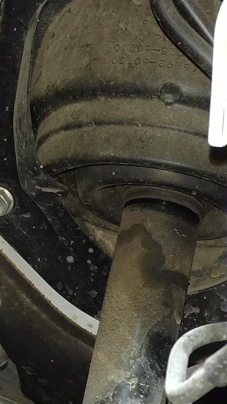

So there is most certainly a boot that covers the steering column shaft going thru the firewall. It's not my daily but I've gotten to drive it to work recently and noticed a weird noise and could almost feel the groan noise thru the wheel. So I cleaned the shaft by removing the top fender skirt push tab and reaching my arm in with a rag. Also cleaned a bunch of dog hair and other stuff off from the inside. Then used a small amount of red grease from the outside and applied to the shaft near the boot, then worked the boot up and down from the inside and cleaned access off from the outside. Weird noise gone as of now!!
