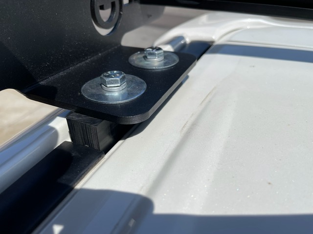

I basically looked at all the systems available and blended a bunch of them (for the rack and mounting system).
It’s not done yet, still have to make the faring and get some stuff powder coated but it’s close!

As of right now I am not going to share dimensions. Couple reasons...
1) I want to finish the rack and use it for a while (and test water intrusion)
2) I used greenlane offroads idea they termed "gutterblock"
Its 100 percent my own measurements and made to my own CAD models, but still their original design idea.

I'll share some photos when the rack is finished!

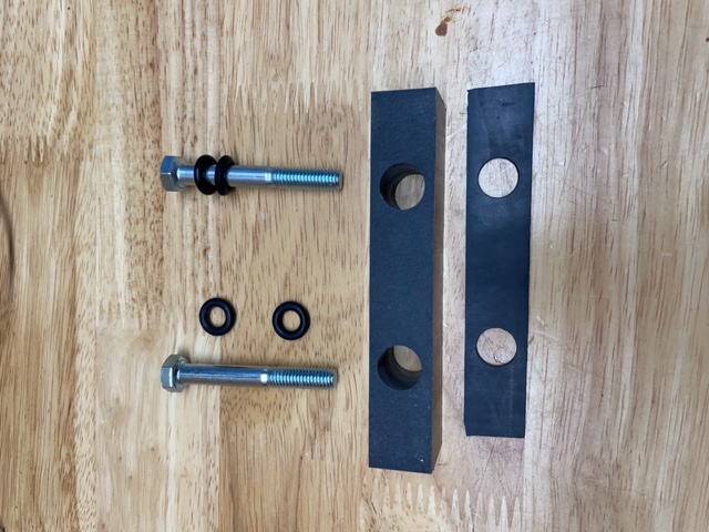

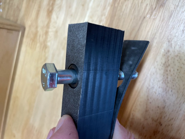

Prinsu no drill No silicone option. Use a gasket under a custom spacer, and two o rings on the bolt shank to stop water intrusion down the threads. All McMaster Carr stuff.
1/16 thick x 0.75 EPDM gasket
0.75 wide x 1.00 high Delrin spacer. Cut to 4.25 long
Drilled thru holes 35/64 inch diameter
1/8 buna o rings -203 size

This is great! What did you search for to find the derlin sheet? Also are the prinsu spacers 1” tall? I can’t get to mine to measure, but I love this idea.
The delrin comes in .75 x 1.0 part number 8662K52, you pick the length. Had to sand the sealing side to take out the grooves.
The prinsu spacers are 1.0 x .75 OD X .50 ID.
Standard 1/8 o rings ID of .296 fit great on the .308 bolt shank from prinsu, but are too thick (0.574) for the .5 ID of the prinsu spacer, so one needs a slightly larger bore diameter. Hence the 35/64 drill at .547 dia. This is a good amount of o ring compression but not too much that it can’t be assembled. One would be fine but you get a pack of 50 so double up.
Used a 1/16 epdm sheet for the bottom. PN 8990K71
If I understand correctly, you put the prinsu spacers inside the delrin block? I'm thinking of taking your idea and applying to my UpTopOverland rack when I get it, looks clean!
