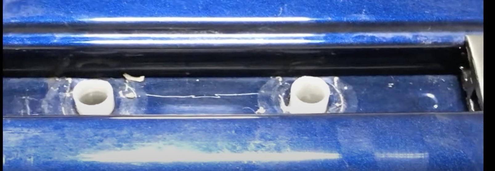

what do you mean "not use silicone"?
All racks you will need to seal the factory mounting locations.

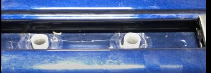

I'm planning to install the Eezi-Awn / Equipt K9 rack that I have on order.
I'm trying to adapt what I know works on the roof of a travel trailer or motorhome. Anyone see any problems?
  • Small amount of black Dicor self-leveling lap seal to fill the gaps outside of the white OEM spacers that surround the bolt hole.
  • Butyl tape with holes cut to go over the OEM spacers
  • Rack mfg (K9) spacers around the OEM spacers but on top of the butyl tape
  • Thin layer of Dicor around the top threads of the bolts
  • Dicor on top of the bolt heads and around any seams
  • Strip of black Eternabond tape covering the top of the entire mounting bracket on top of the bolt heads
One of the K9-specific issues is the need for washers to level out the K9 spacers in some cases. I think I might be able to wrap the outside of the K9 spacer and washers with butyl tape. Or maybe put the washers at the bottom and use Dicor lap seal. I don't have any great pictures of what this looks like after it is installed so it's tough to plan ahead.
