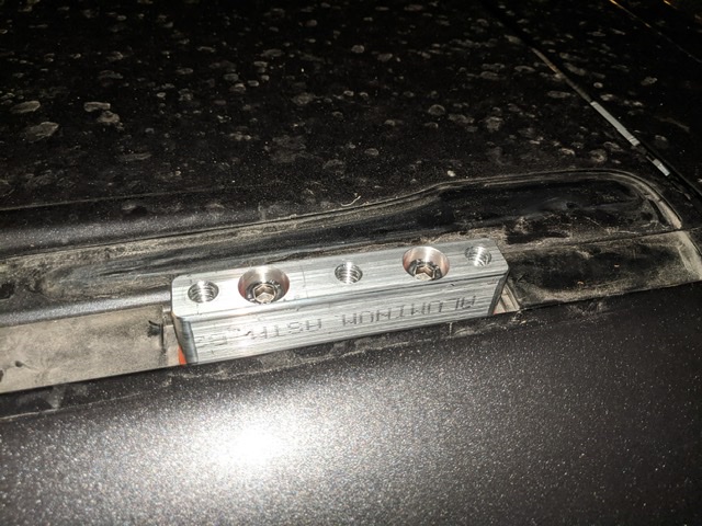

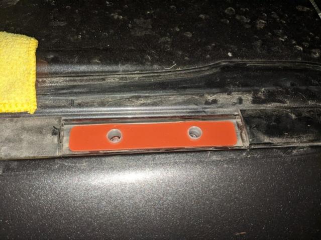

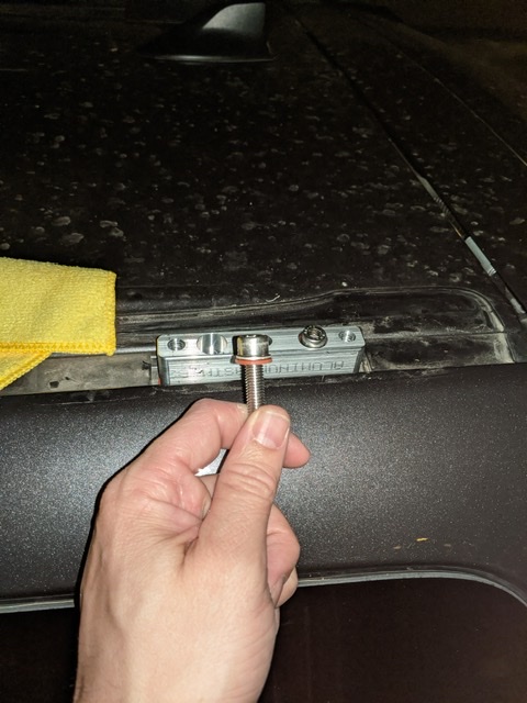

not sure if i did this right but i am currently installing the victory full length rack put the butyl under the silicon washer and am getting ready to place the rack soon as my 3rd and 4th hand get here
probably could have cleaned it up a bit better but don’t currently have any alcohol laying around so i just wiped it as best i could.
since it’s not actual silicon going on didn’t think it would be too bad.

Where did you buy the washers? All the ones I find at local hardware stores are too flimsy and not thick enough.
i had the same issue i went to mcmaster carr website as everyone else recommended paid $15 after shipping. if you were local i’d give you the rest since i only used 8.
