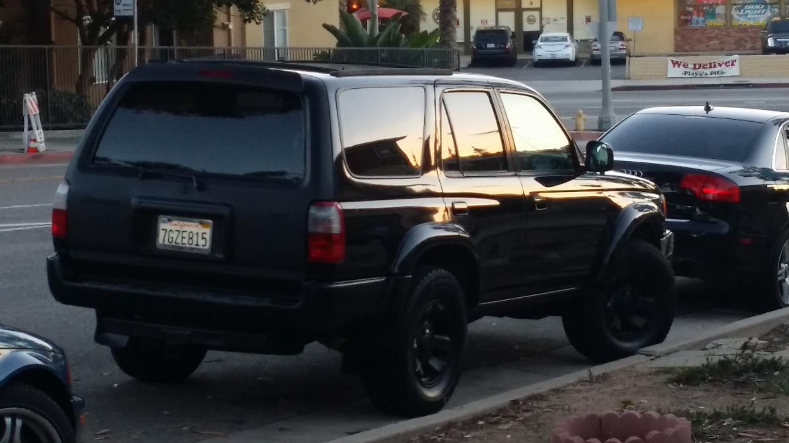

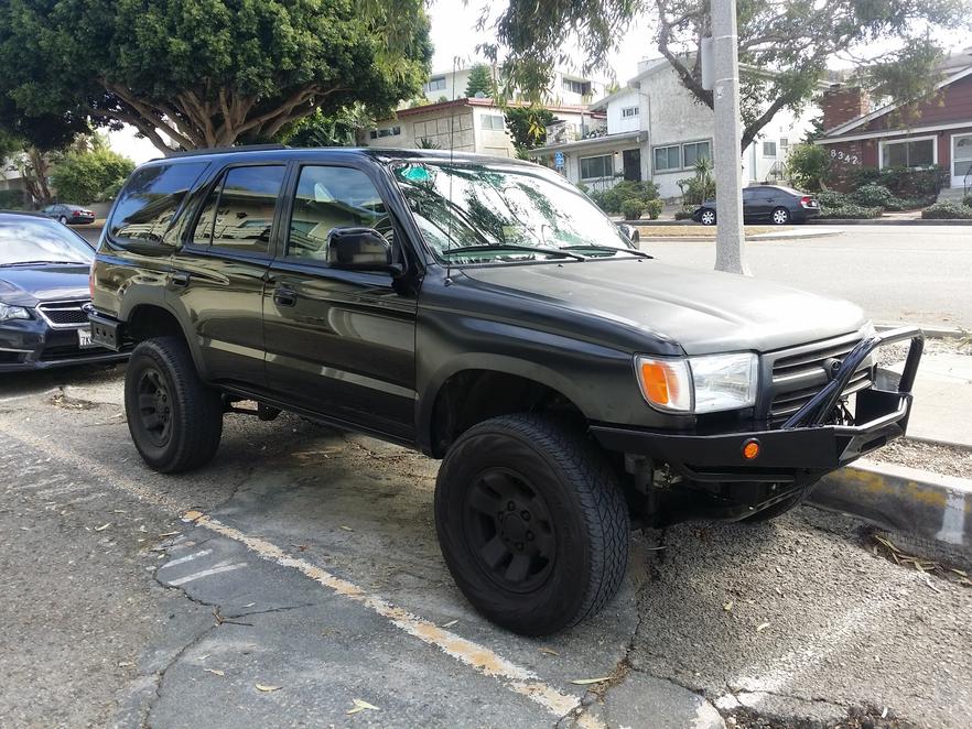

wee update
Ok so I will take some glamour shots later but I have a couple for the meantime.
So far I have done a few things, feel like the list just gets longer.
Tundra front calipers, rotors and pads, 199mm not the 231, smoking deal at the local parts store and no need to fiddle with my wheels.
Extended rear brake line.
Bilstein 5100's with OME springs front and rear, new front perches.
Addicted offroad rear tube bumper
Addicted offroad front plate bumper w/led signals
EP35 flasher relay
Removed old busted front fenders and replaced with new aftermarket pieces, no more flares!
Removed rear flares, taped up holes and plasti dipped for the time being.
Ditched the running boards.
Replaced the cruise control switch.
Engine oil & filter, trans oil, brake fluid flush with new brakes.
Superstar headlight bulbs, stop gap until I have all the pieces for a HID setup.
Tidied up a bunch more interesting wiring i.e. removed a ton of crap that was just along for the ride.
Radio antenna from broken powered unit to a whip.
Steering rack guide, clamp and bushings.
Basic garage alignment after the lift to get my front camber back to "0" and toe corrected.
So late July after we picked it up....
And as of yesterday...
Not sure if attaching pics is working (user error) lets see.
