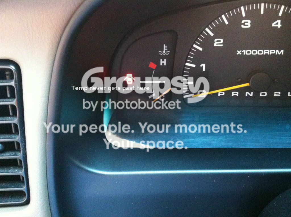

Quick question...my temp gauge isn't numbered. I don't have a scangauge, or an aux temp gauge. My level is always slightly under half-way...I marked it with the white line. Anyone know what that temp is? I assume that its around 190-200, but I've never know for sure.
