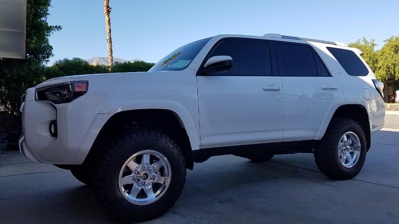

you'll be fine with 2.5 in the front and 2 in the rear. I have the bilstein 6112's in front and 5160's in the rear with Icon 2" rear coils. Check my garage link for part numbers.
It will drive like shit at highway speeds, until you get some UCAs and get an alignment for max caster. Try to get as close to +4 as possible.

That is a front. No I did not have limit straps on the rear.
