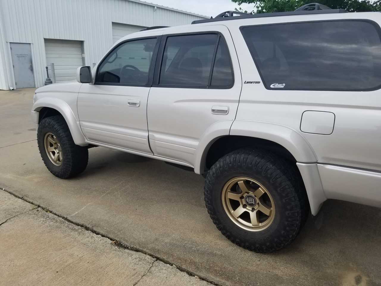

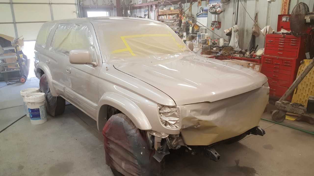

Not much of a build but... IT WORKS
JasonBass

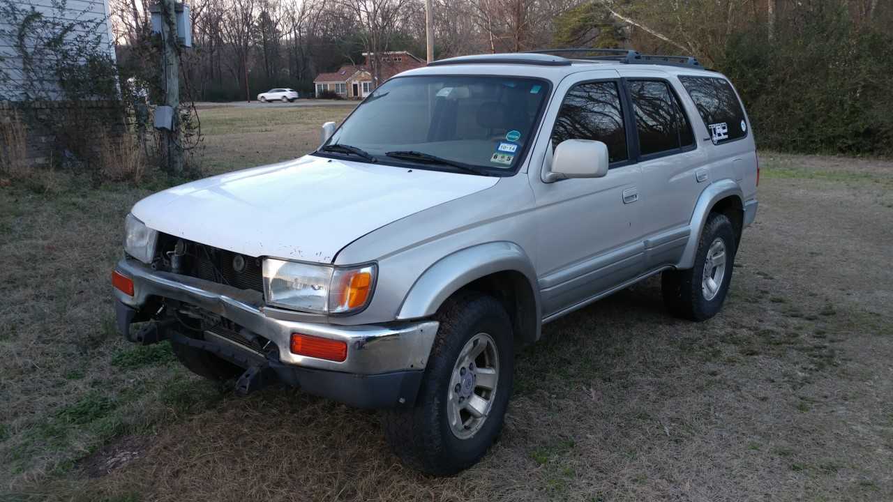

got this for next to nothing after it hit a deer
1998 limited 2wd
all power with working a/c!
new p/s rack
new timing belt water pump 40k ago
new auto shifter bushings
new moog lower ball joints

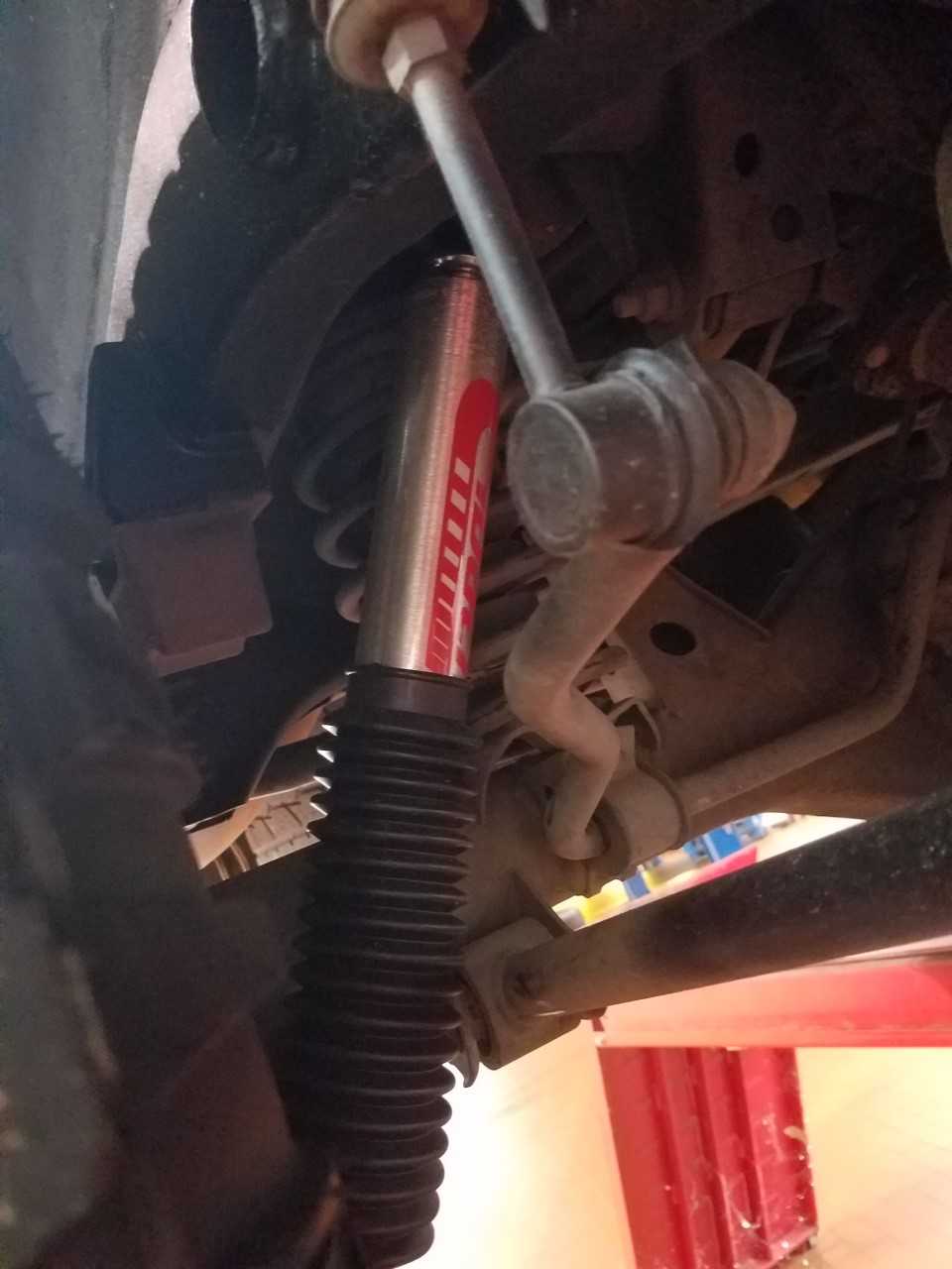

new xrs? sway bar links -front
new gear indicator number plate
eibach pro-truck shocks in rear

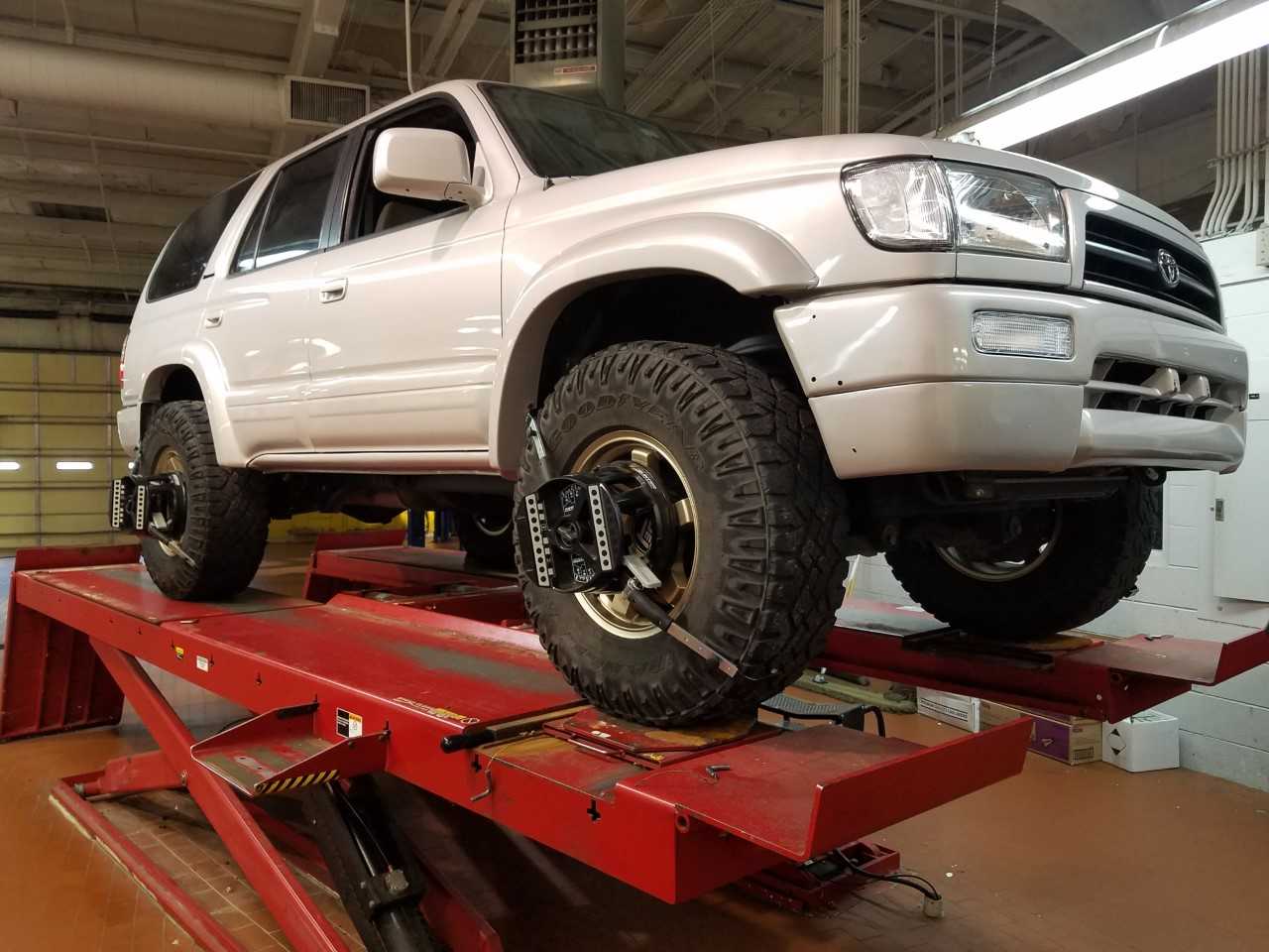

level-8 16" wheels with way to big 32's
some brand f+R spacers

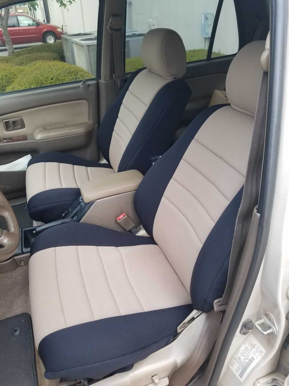

wet okole seat covers
all clear euro front lights

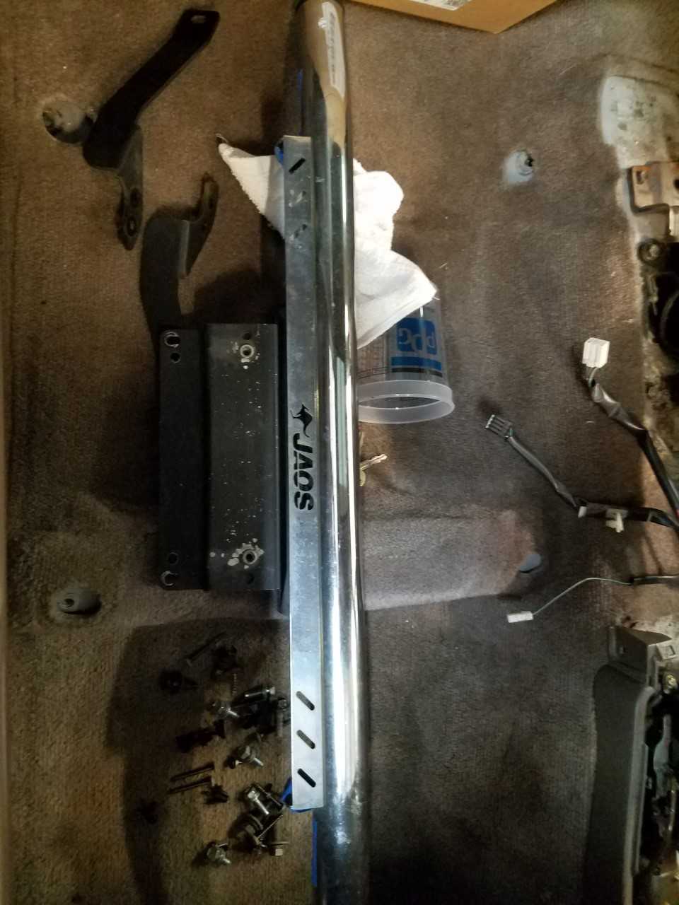

jaos light bar that I don't know how to mount
two hella 500s not mounted yet

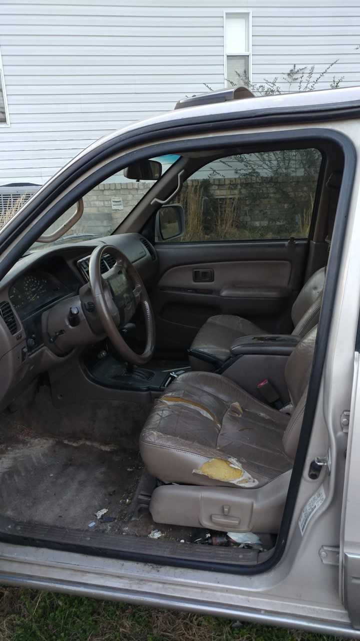

before and after

What kind of paint did you use to paint over the chrome? Or did you just sand it down?
I'm not OP, but fwiw I lightly sanded mine, and primed it with the Rustoleum self-etching primer, and then sprayed rattle can Rustoleum truck bed liner over that. It's held up great for 3 years through winter.
I love the self-etching primer for any bare metal painting. Different companies have their own versions, ie. U-POL Acid#8.
Well done! Props for doing your own paint job, I chickened out and just used a rubbing compound to restore my paint.
