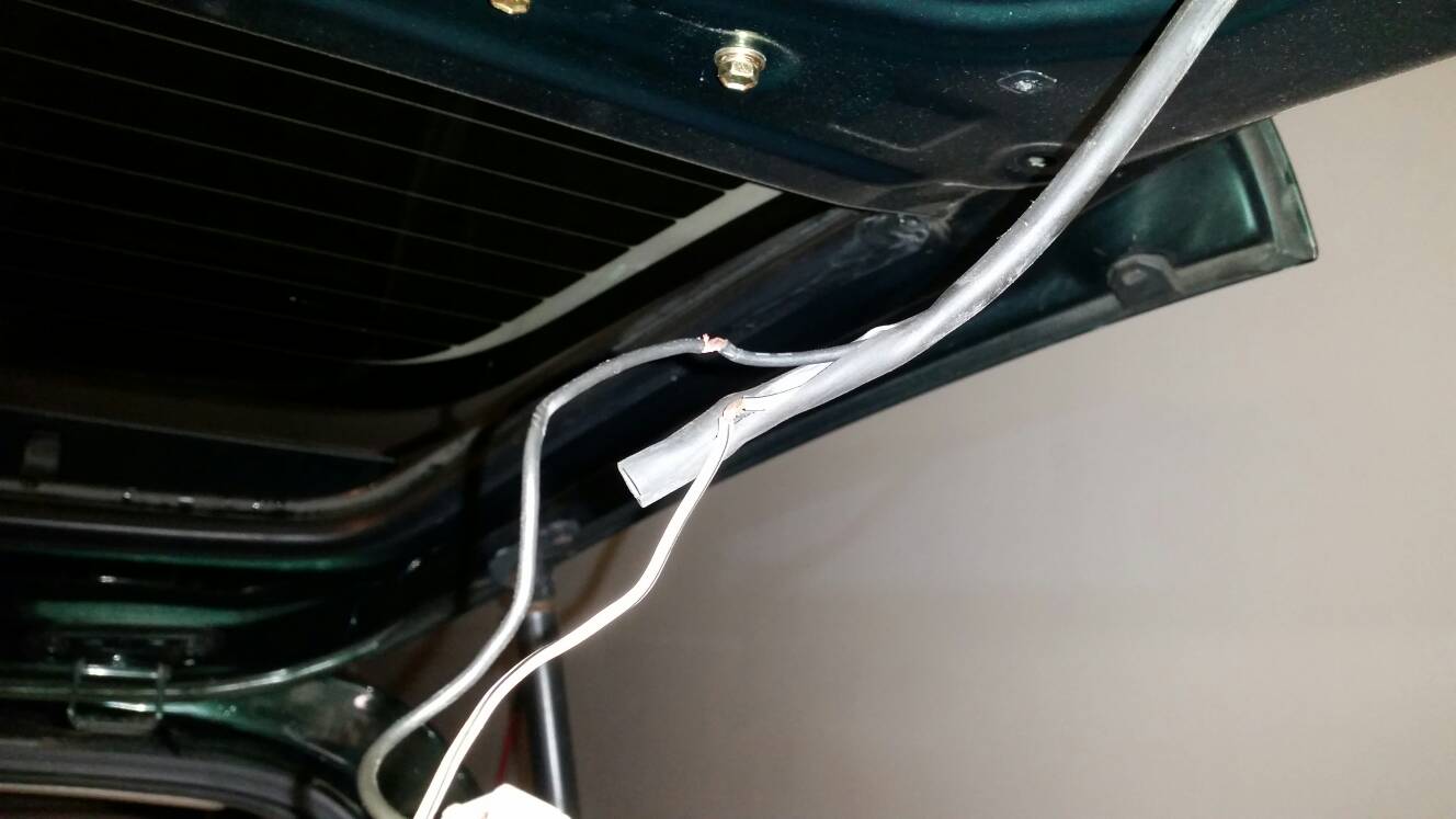

Since I have my rig I had problem with rear defogger, fuse just blown each time I change it. Finally I got time to look close what is wrong and I find this...
Look closer

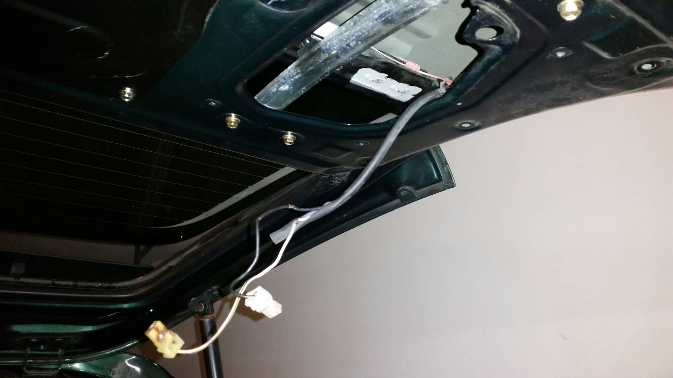

Good isolation tape fix the problem.
In my opinion there is wrong design b/c when window is all up wire is extremly bend and with time wire isolation just crack and make short.
