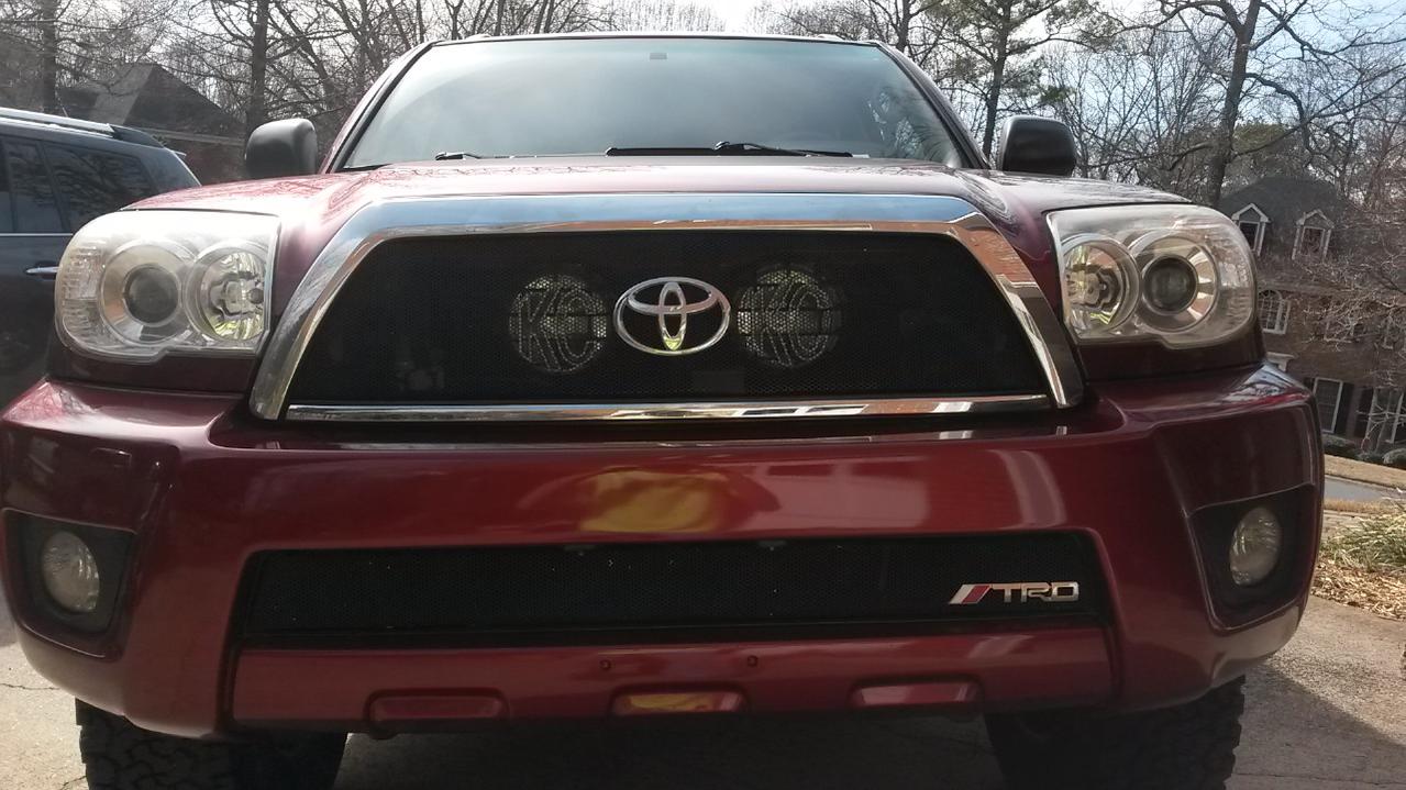

Finished with the grille mod. Thanks Mytoy4 for the writeup, it was a great reference.
-I used 22 gauge galvanized steel (circle pattern - see the very top of the webpage haha), and mounted it onto the metal hood support with fourteen #6 stainless sheetmetal screws and lock nuts (it's not goin anywhere).
4Runner V 2.1
Gonna attempt to do the lower grille this weekend... and probably another 2 coats of enamel since i scratched the heck out of the inside while mounting it - better pictures to come.

And introducing: behind the grille fogs!
Thanks [MENTION=83576]Southern4Runner[/MENTION] for the KC's
