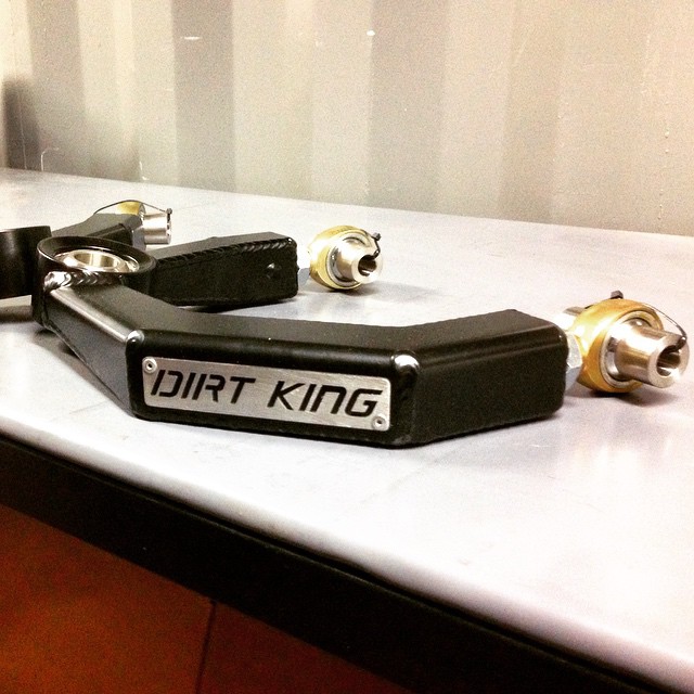

so, if I understand you correctly, these are constructed from a one piece top plate, and several other segments which compose the walls and bottom plate? if this is the case, there are in fact many more welds than I would have thought were they constructed of segments of hollow square stock...
Im not really sure as to what you are thinking, so we went ahead and contacted the guys at Dirt King to hopefully jump in here and shed some more light on their design and answer any technical questions.
For now, here is a close up on the arm that might give you a better idea of how it all goes together.
Cool, looking forward to an explanation. Not trying to rag on your product, just interested in the pros and cons of each design philosophy
it looks like the arms arnt made from square tubing, rather two ends of metal that have been layered and put into a press brake to be formed and then welded together, like a jig saw piece.
if that is the case, they should be heavier duty than the DOM tubing versions, albeit much heavier.
look at the arm in the attached picture. there arnt any weld seams on the top, only on the sides - and if you look closely you can see a bead tracing the edge of the bottom of the arm. a welded clam shell if you will
that manufacturing technique, if they have a laser table to cut shit, a jig to build them in, and a CNC brake to bend them correctly every time - should net in very precise arms. that coupled with using heims would allow for some serious adjustment, especially in the anti-dive department (to alleviate nose dive, if you're savvy enough with alignments)
sounds to me like this is quite the winning combo, if you're willing to deal with the added maintenance
... that coupled with using heims would allow for some serious adjustment, especially in the anti-dive department (to alleviate nose dive, if you're savvy enough with alignments)

the added maintenance would be regulated to the Uniball and the heim ends. the uniball will start acting up long before the heim joints do, simply because its on a horizontal plane and debris will have the opportunity to sit ontop of the joint and work its way into the race, as well its constantly exposed to road spray due to its proximity to the tires
the heim ends being mounted vertically (relatively) will fare far better. the key would be to be replacing them with high end ones when it comes due, like FK rod ends. their races are of much much higher quality and last a lot longer. 3-in-1 lube that they sell at lowes and home depot is the best lubricant you can give the joints.
that said, a nod towards icon and camburg, they both offer caps for the uniballs they use (Camburg uses a larger 1.25" uniball, the largest in the industry) that keeps the debris from entering and sitting on the top of the joint, but the bottom is still very well accessible to salt and shit
