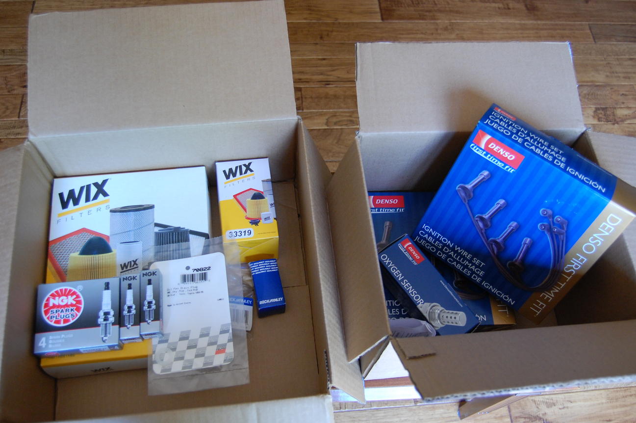

Got my parts!

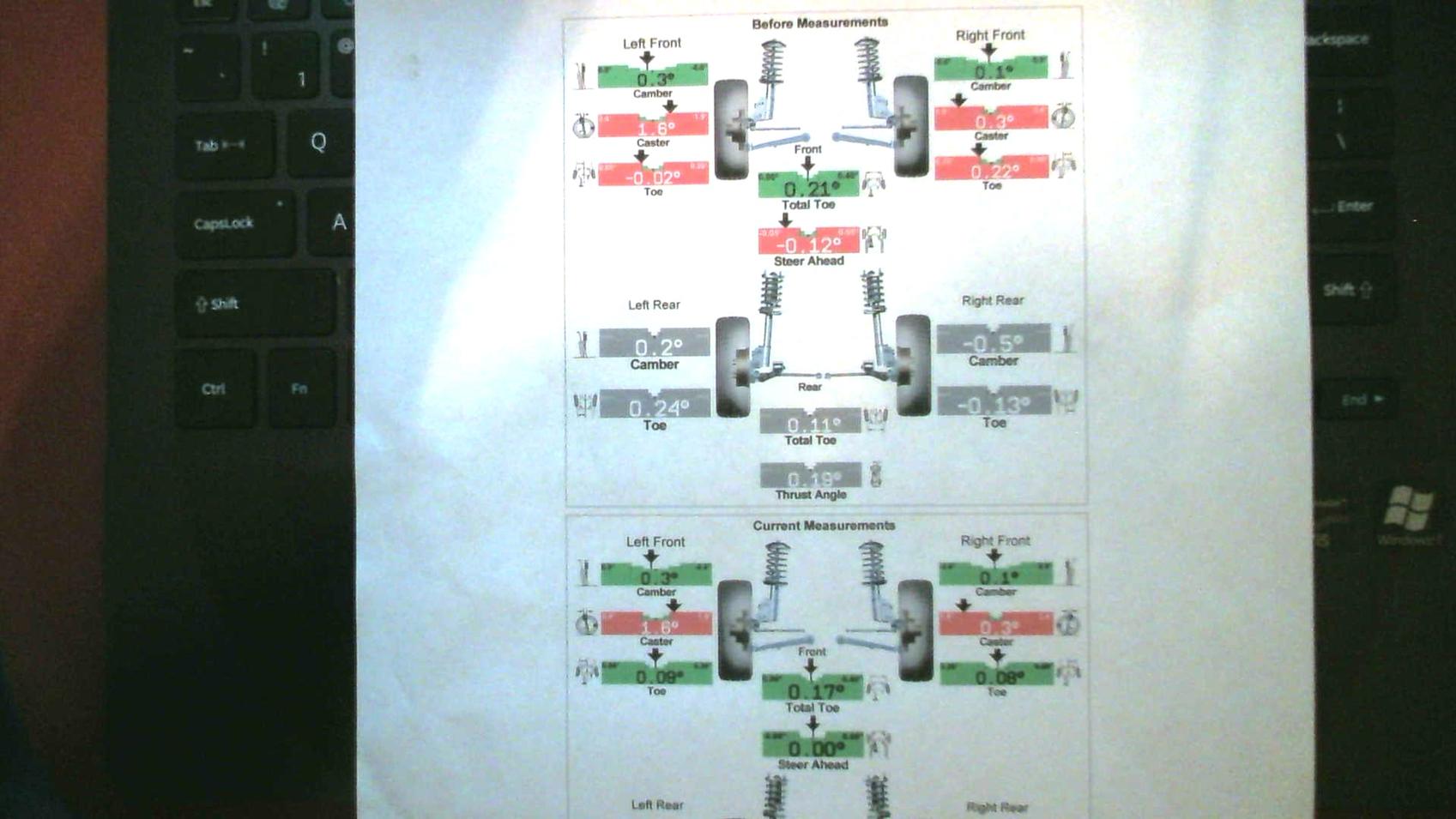

Also, got it aligned. What do y'all think about the results? Seems to drive much better now but I haven't been on the highway with it yet.

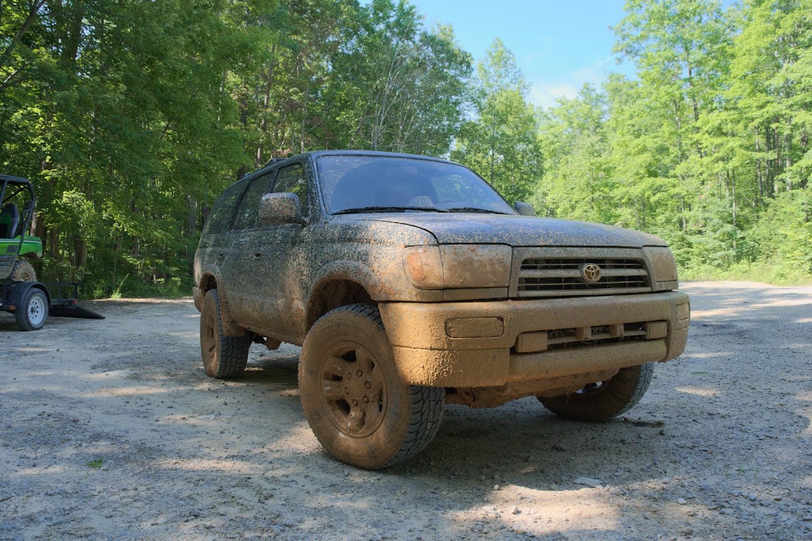

Since it's been a while, here are a couple new pictures:
