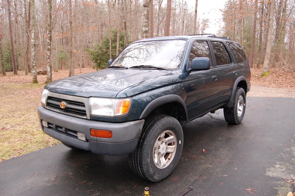

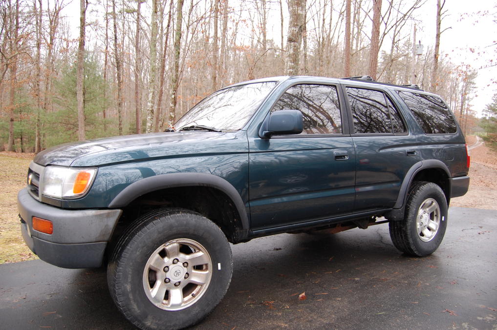

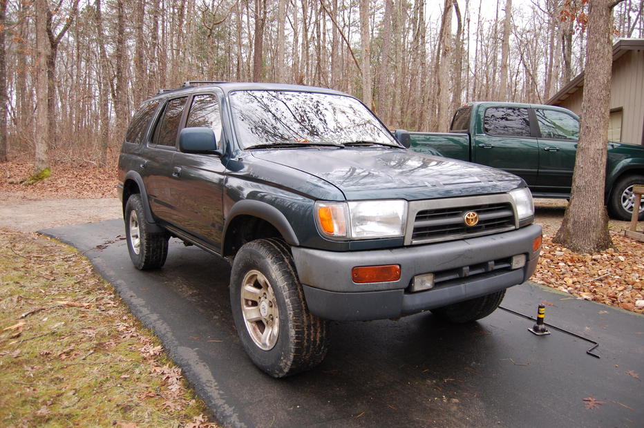

Here are some pics with the running boards removed. All of the suspension parts I mentioned earlier are installed, except for the sway bar bushing. Still gotta find some that are the right size.
Next stop is the alignment shop.

Good to see your bringing a beat up runner back to life. The frame rust looks mostly fixable, lot of sanding and surface prepping in your future. Might have missed it, any plans on fixing the paint?
Thanks for the reply. I still haven't decided what I'm gonna do about the rust, may just sell the thing and buy another one when I gather the money. It was a freebie anyway. Could use it as a donor, engine is impeccable.
May plastidip the hood and roof to prevent the paint from peeling any more, don't think I'll paint it.
In any case, I absolutely love it and it's got me hooked on 4Runners. :driving:
Any comments are welcome.
-NR

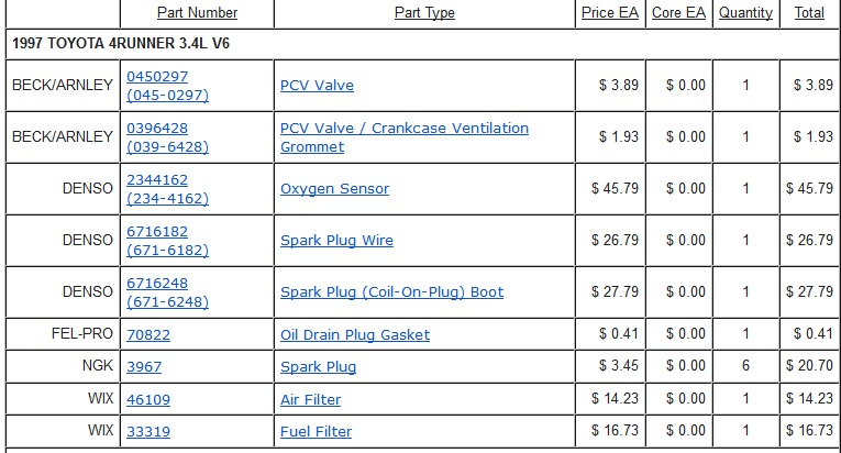

Considering buying about $150 worth of tune-up items (spark plugs, fuel/air filters, o2 sensor, etc.) from RockAuto. It seems my total cost buying there is about half what it would be buying from somewhere like NAPA or Advance.
Would you guys advocate buying those things from RockAuto? All of the items would be from brands I trust (Denso, WIX, NGK, etc.). Basically I want to know if they are reputable enough that I wont have to worry if I have to return something.

I've ordered from there a few times. Never had any problems.
Ordered a load of stuff from RockAuto. Should be here by next weekend. :biggrin1:
