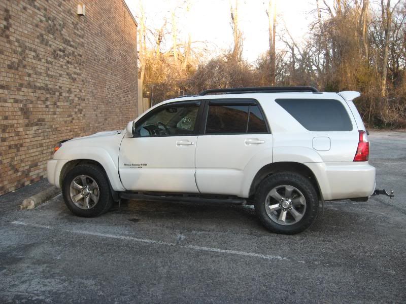

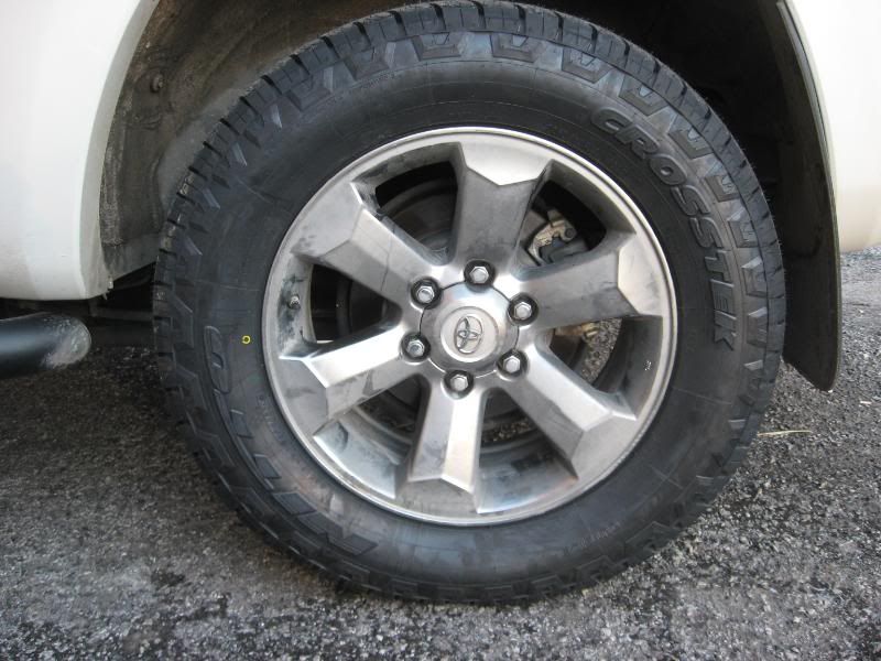

my local NTB install Nitto's on my 4R earlier this year w/o an issue
IMG_1863.jpg~original
IMG_1864.jpg~original
IMG_1865.jpg~original
