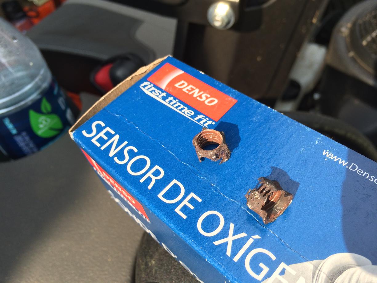

On a long trip I noticed my engine sound getting deeper and louder. I just figured a hole rusted through somewhere in the exhaust pipe. I stopped in a store, and walking back to my truck I noticed my O2 sensor hanging down. Looking under the truck I saw nothing but rust left on the studs. So those of you who say the nuts don't just rust away, they do!
229K in Delaware, on the beach? I bet they do. It's also possible you are on your second sensor and non-stainless nuts were used at that time. In general, though, the OEM nuts outlast the sensor, if not by much.
