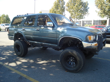

So i have two problems with my truck. Nothing to big.
The first is the o2 sensor. The code comes up with code 21. The shop said they need to check all the wiring but most likely the o2 sensor. The cat was she replaced around 2-3 months ago. The CEL comes on every month to month n a half. So it doesn't come on all the time so what do you think it is? The truck jerks when you don't give it enough gas like its being starved! It seems to stop as the truck warms up though. Is this the fuel filter or the o2 sensor?!

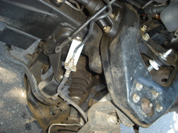

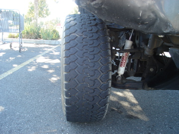

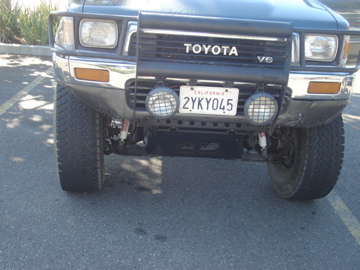

The second is my passenger side tire. I am in the market to get new tires but I need to fix this problem. I don't want the tires wearing uneven. The top of the tire seems to stick out a little like its facing outward. Can this be an alignment or something different?

You need to have an alignment done, it looks like you have too much positive camber. positive camber is when the top of the wheels lean out \--/ negative camber is the opposite, when the top of the wheel leans in /--\. Caster is wheels axis forward and back. these are both adjustable via the eccentric adjusters, (the offset bolts that hold the lower control arms to the frame)there is also toe adjustments. I wouldnt recomend trying to adjust it yourself because when you move the eccentrics it moves the camber and caster, and if the caster is off your truck is gonna pull bad. hope this helped some.
i agree with T-Dubya, your camber is off. if you take it to get aligned, mention that you noticed it is off and that you are wondering about it and they should let you know if any parts are failing, otherwise they should get it straightened up.
