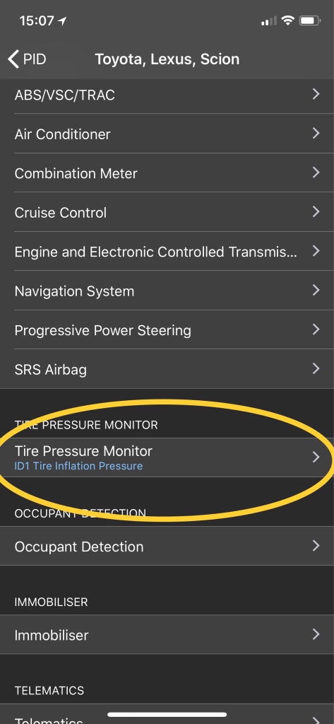

Anyone using OBD Fusion on ios and able to get the tpms to display the actual tire pressure?

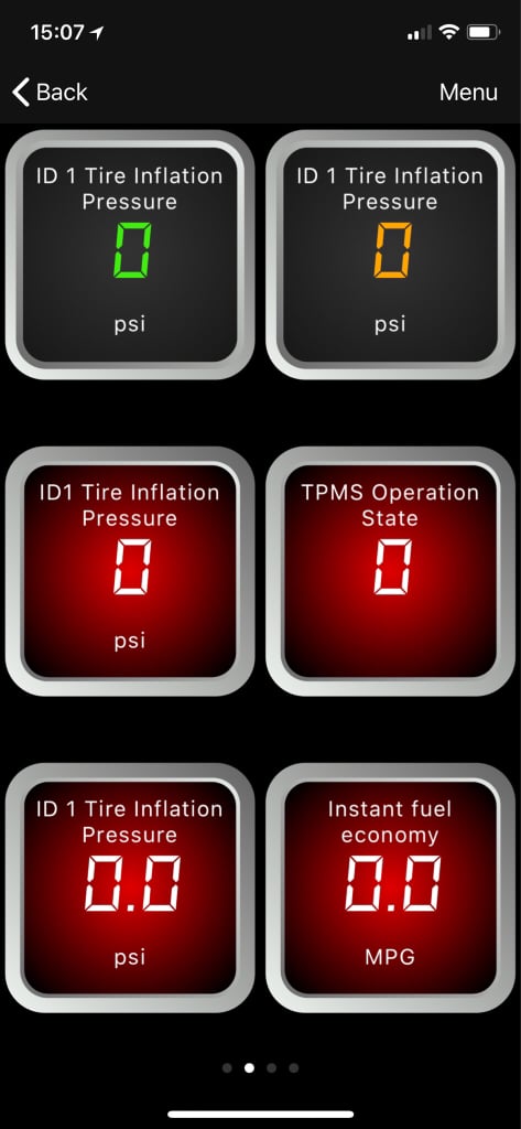

You can set it through display configuration>Toyota,Lexus,Scion>tire pressure monitor. But I think I have something set wrong because the display windows always show 0. I'm thinking maybe there is a setting to tell my carista obdII reader to read that as it doesn't look like it's a "network A" PID code.

I thought about that but wondering how then the idata link maestro reads them for aftermarket head units. That device just hooks to the obdII port as well, guess it has better internals. Scanguage will read them too.
Been scouring forums looking for the PIDs to try and manually add but can’t find them
Looking through the forums when I was considering it, and from all of the custom PIDs, they just don't seem to exist
The Maestro reads TPMS off the SIL wire at the OBD2. Most OBD connectors only read from the can bus wires there. I have Carista and access to beta testers and the beta version of the app that was supposed to see TPMS but I never saw anything with it.

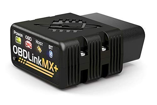

This adapter with OBD Link or OBD Fusion should get you TPMS on 4R as well. Easy plug and play and seemingly the closest to a portable Techstream I have seen. It sees into all modules and easy to throw up all your gauges for AT temps. It is also firmware upgradeable from the Link app.
https://www.amazon.com/OBDLink-Bluetooth-Professional-Grade-Diagnostic-Performance/dp/B07JFRFJG6
The advantage of OBD Link versus Fusion is that it gets you all of the $9.99 vehicle add-ons for all vehicle. Fusion makes you buy each one so if you plan to use on multiple year and brand vehicles Link can be a better deal. Link comes with the adapter.
