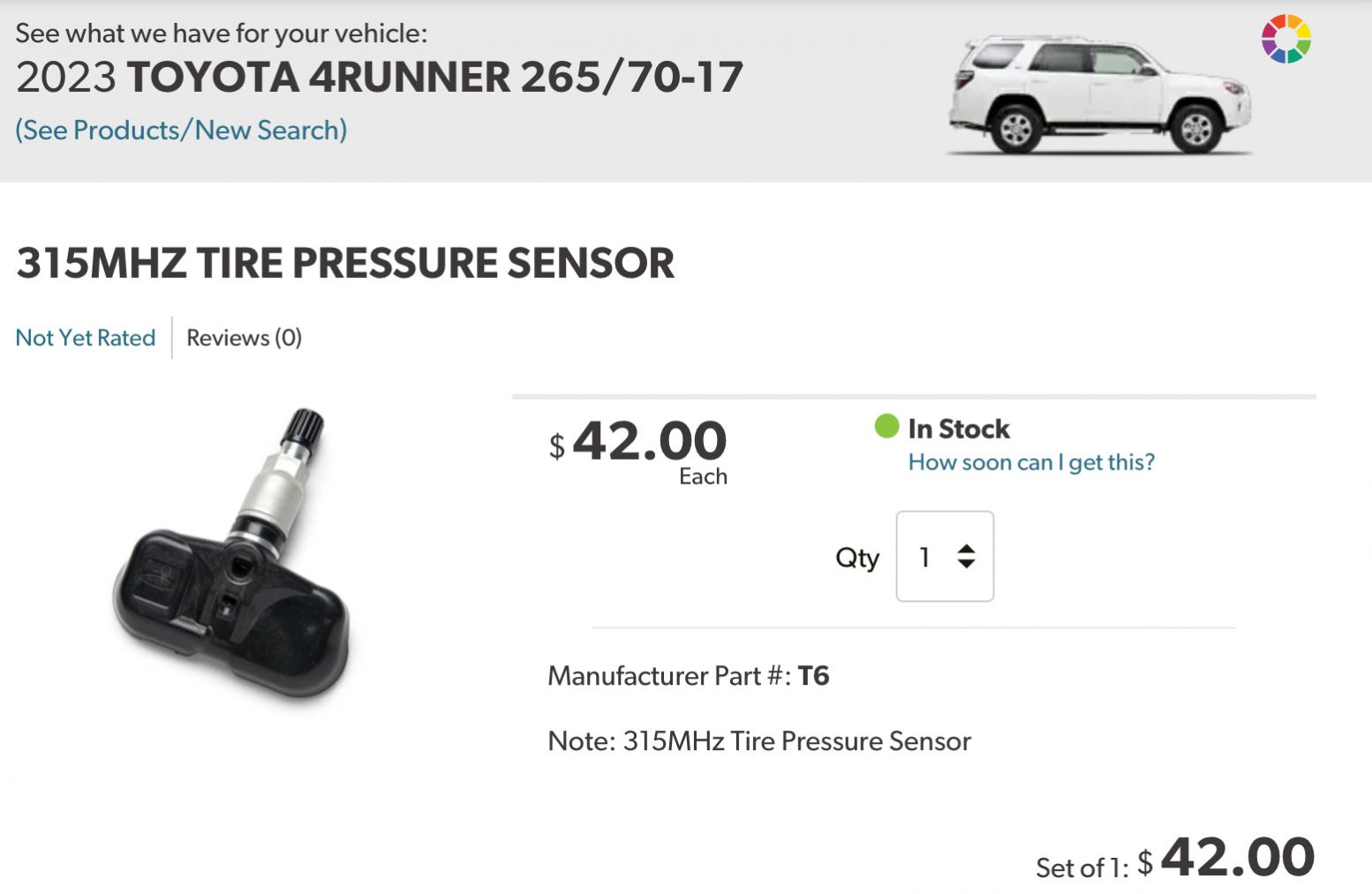

I’m doing the same, but purchased a set via Tire Rack…installing next week.
