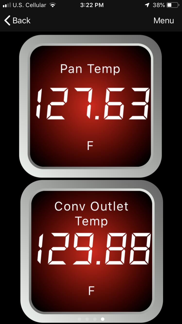

This may be known to most of you, but I just spent a few days searching for an easy way to read trans temps. I tow a lot, and with summer coming, I was stressing about towing in higher temperatures. All of my other vehicles I've had, I plumbed/wired in a gauge but I don't have the time right now to do that.
OBD Fusion with the Toyota Enhanced Diagnostics will recognize both A/T Temp 1 and A/T Temp 2. This is on my 2008 V8 4x4 Limited.
I connect with a Veepeak OBDCheck BLE OBD2 Bluetooth Scanner and have the OBD Fusion app on an iPhone 7.
After all the reading I did, I had a couple pages of formulas ready to go to find the correct one to configure the pid. Thankfully, it was literally plug and play.
In the picture, my truck had been sitting for a bit after I got home from work, hence the temps below 130

I have the same setup and it works well. IIRC, the only time mine approached 200 was out on a trail.
