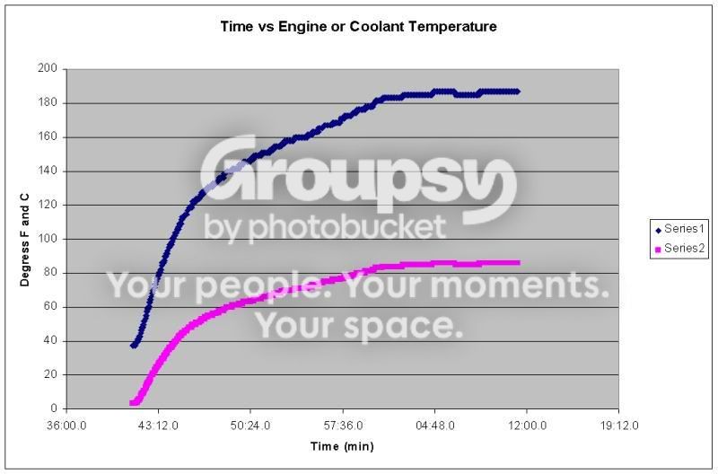

Here are two more: CTS coolant temperature sensor (blue-line degrees F & pink line degrees C) One can see a change in slope at 120 F. This is probably the thermostat opening.
temp-1.jpg~original

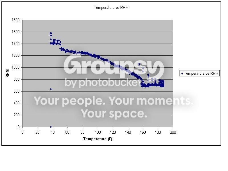

And idle speed. The test was starting with a cold engine. I waited for the thermostat to open for a few minutes before terminating the test.
tempVSrpm.jpg~original
