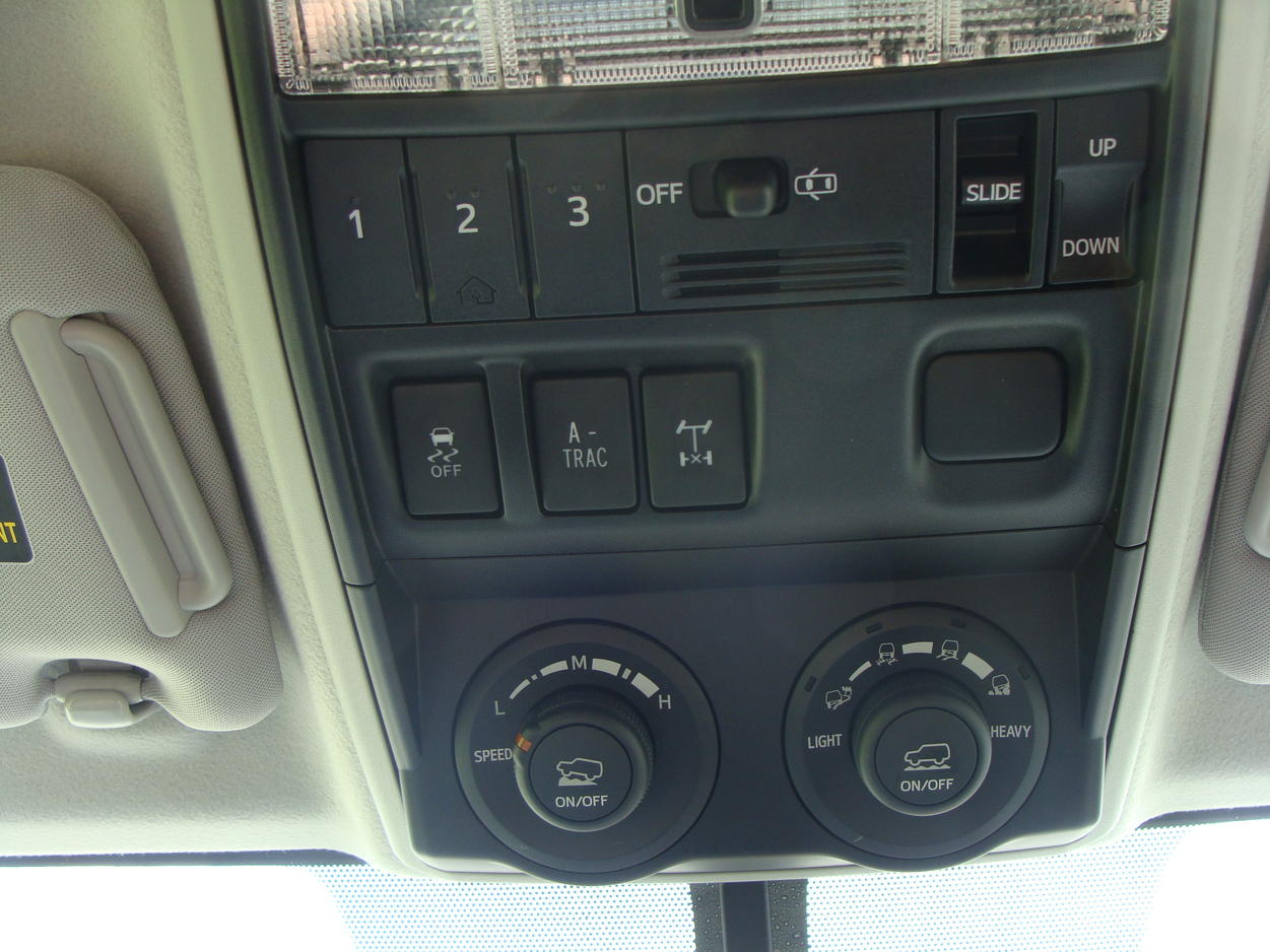

Did you accidentally hit the wrong button while using your garage door remote?

Definitely not, parked out in an open parking lot so not touching those buttons. Even then you'd have to hold down that traction button for x seconds to turn off abs right

There is no button to set off an ABS warning light.
