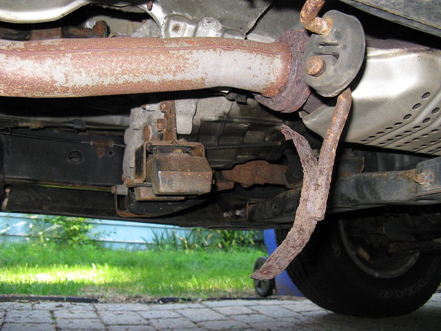

While trying to get the farthest bolt on the exhaust side of my hitch, the hanger welded to the cat (was/is very rusty) pulled away and is no longer attached. Can it be welded back even though there is ton of rust?

any opinions on the busted exhaust hanger? do you think it can be welded back on? any other options i can do myself? i am no welder!
That sounds like a question to ask a muffler shop where they could look at what you need welded, as well as what you want it welded to. There has to be metal left, you can't weld rust. That hangar looks like it should just be replaced, and a muffler shop should have one in stock that would do the trick.
That hanger is a separate piece from the exhaust. I would get a new hanger grind the bolts off the cat and install.
ah ok. so the hanger will wrap around the exhaust... grind off the bolts and attach the new hanger. now i just need a grinder... lol. i may just take it somewhere
