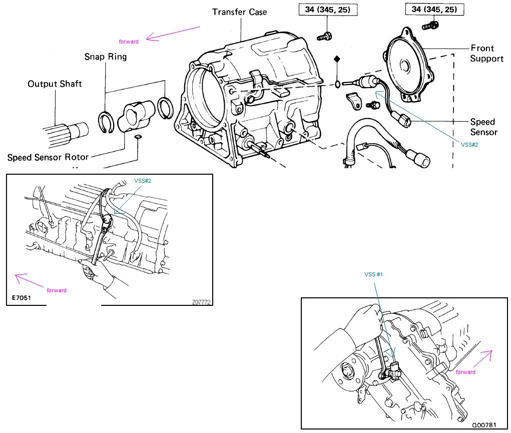

I am having this issue currently, my speedometer is also all electronic. This is what I found in the FSM:
I replaced the No. 1 sensor which has the gear and the 3-prong sensor. I checked both connections and neither seem lose or whatever. I was getting a CEL for the sensor and when I replaced it I no longer get it, but alas speedometer and odometer still do not work.
