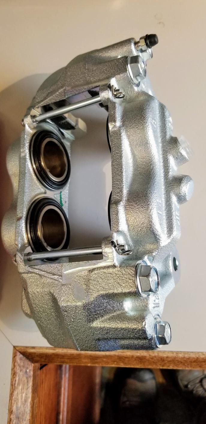

Like many of you, I discovered my lower inner piston seized. I had already purchased 4th gen rotors and pads so I didn't want to upgrade to 5th gen for the time being. I ended up deciding on OEM calipers for 224/ea. I figure the originals lasted this long maybe it'll be worth the extra dough. Anyway, I received the calipers and they appear to be bare. Either that or perhaps they are galvanized? I'm wondering if I need to coat them before installing.

that's just what they look like when they're new and not covered in brake dust and road grime.
Give them a few weeks, they'll be nice and rusty.[emoji6] I want to get mine powdercoated but I don't want it being down for a week and losing all the brake fluid. I've heard when that happens you have to bleed the MC but I'm not positive on that.
Clean them with brake cleaner and paint them with the caliper paint of your choice. Give them a few good coats, install them then touch up.
I coated mine with ceramic 9h coating. Pretty much makes it super easy to clean. I had a friend hook me up though with the ceramicpro 9h. I used it on my wheels too. Might want to consider at least clear coating it with high temperature paint to protect the calipers from the elements.
They appear coated with some type of silver..
Where it seizes up is between the piston and sleeve.
Liberally apply grease under each piston boot, to aid in preventing that.
It's best to bleed the entire system to get fresh fluid in there.
Part of preventing corrosion.
