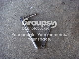

1) Your 2003-2005 4Runner with the OEM lights (blah). Tools you will need (10mm each):

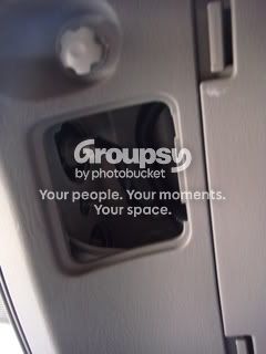

2) Starting on the driver’s side (this removable panel is identical to the one on the passenger side), remove this panel, you will then observe the “cubby space” to remove/replace the bulbs.

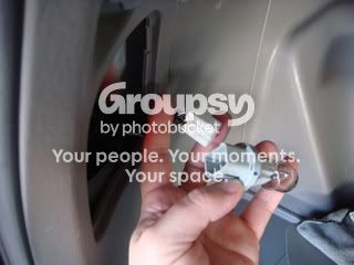

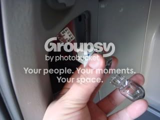

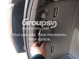

3) Remove the bulb socket, then the bulb itself!

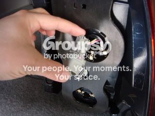

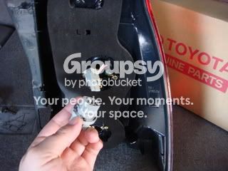

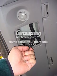

4) Now, go to your LED tail lights and connect this “bulb socket” to the “male” connector of the LED lights. You can only snap it on one way (so don’t worry if you think you will connect it incorrectly). Note: the part of the socket you are plugging in is where a normal bulb would go.

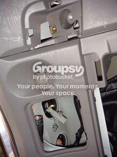

5) Proceed to remove (not necessary, but allows you to see what you are doing back there) the panel above to where a factory cargo net would attach to (see picture). As you can see, I wedged a mag-light to see where to remove the upper 10mm bolt. To remove the upper bolt, you will need a small 10mm wrench (the ratchet I had would not fit in the cubby hole) Proceed to remove the lower 10mm bolt (picture). You will use the ratchet as it easily fits inside. That is all!! When you remove the two bolts, the light assembly should come off.

You already have the "bulb socket". When you disconnect the tail light plug, you take the socket out (it will be attached to the bulb), remove the bulb, turn this socket "around" so that it will snap into the LED tail light connector.
