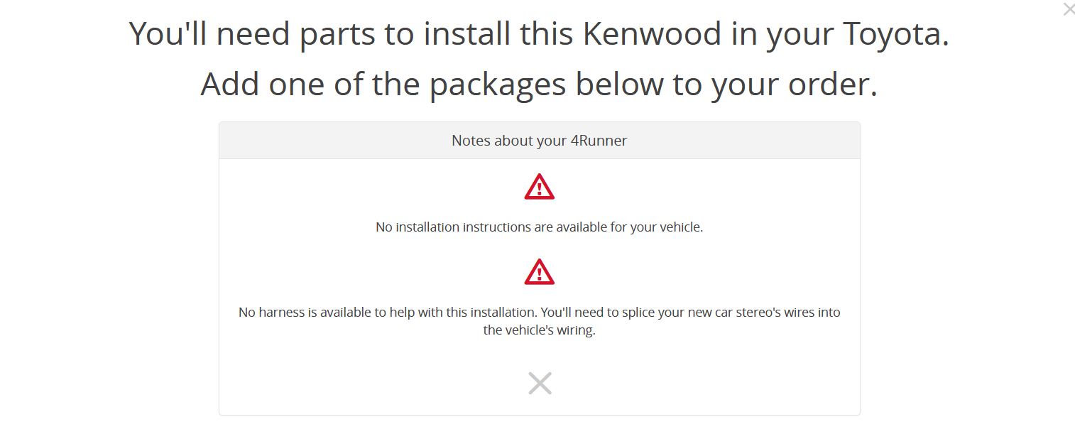

Are you sure? I just did a search on Crutchfield and this is what I saw:
Nevermind I was just looking at the select your vehicle model spot. It doesn't even look like I can splice this oem unit into my current harness, it's missing the black circular connector and my current harness has a lot more wires than the oem radio harness.
