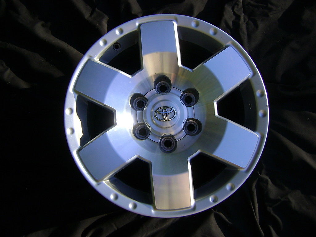

I believe these are the measurements for the 16" TRD wheels, off an FJ Cruiser I think.
16x7.5"
15mm Offest
4.34" Backspacing
Edit: On second thought, it appears I am incorrect. 4.75" according to http://www.trdsparks.com/displayparts.php?Mdl_dtl=533&Part_cat=16&parts_id=1057

The Fj 17 is 7.5 in. The trail wheel from 5th gen is also 7.5. The sr5 wheel is7.
Fj 8 holes wheel has some rubbing with 265-70-17 at full turn while going over rough surface.
No rubbing with sr5 wheel 265-70-17 at full turn.

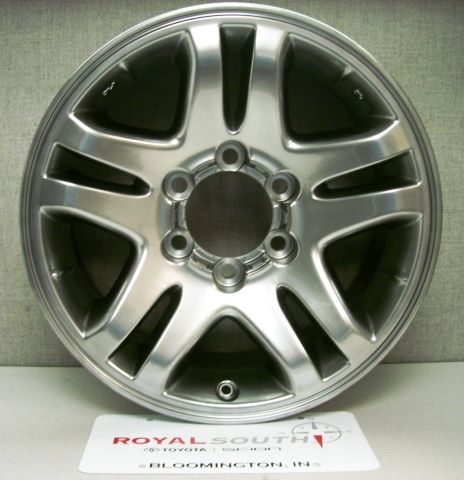

What about these two wheels? Is 265-70-17 a decent size tire that's not huge but still has a somewhat large look to it?

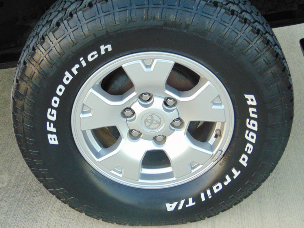

I'm thinking from what I've read this one needs a 1.25" spacer, right? I'm not so sure I like the looks of this anymore, though. Looks great on a Tacoma, but the more pictures of 4Runners I see with them the less I like this wheel for that application. I wouldn't have to buy new tires, though, and I really like that aspect of using them!

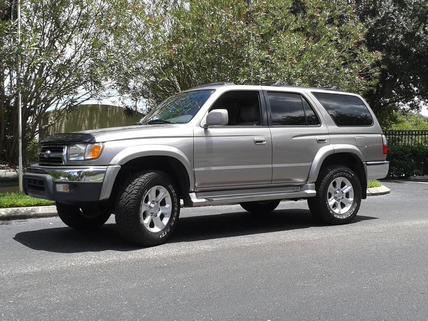

The tires are 265/70R17 with the 2015 4Runner rims. I don't have a lift, everything is stock. 2002 SR5 Sport Edition, automatic, 2WD.
I know I got a great deal on these wheels. $600 for off the showroom floor rims and rubber. The tires still have the little rubber hairs hanging off!
Wow! Great looking wheel! Those are bringing nearly $500 to $600 a set without tires on eBay, so yes you got a deal!

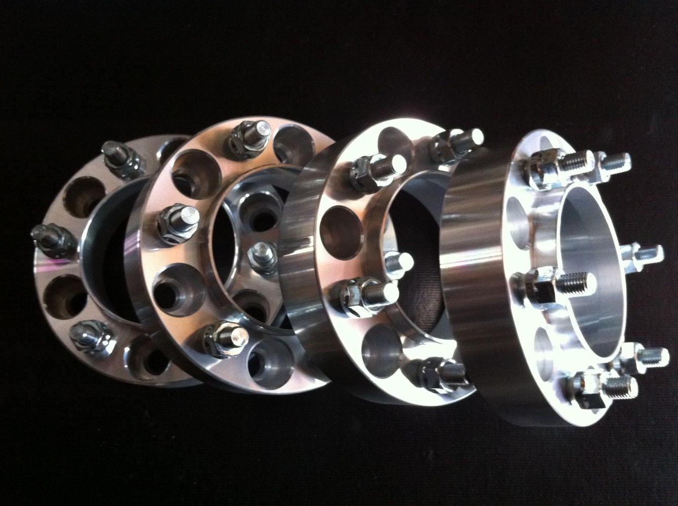

Has anybody used these spacers:
4 Toyota Tacoma 4Runner Tundra FJ Cruiser Wheel Spacers 1 25" 6x5 5 Hub Centric | eBay
These guys have 100% positive feedback and great comments on their spacers. Seems that's all they do and their communication has been fantastic, as I've sent a few questions.
