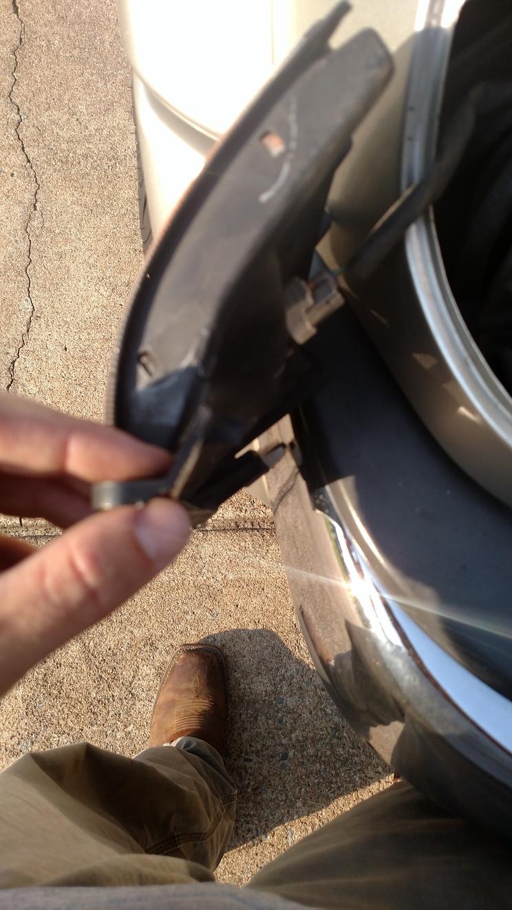

Hi, habanero! I made the change following your reply, first I unhook the spring then take out the clip on the photo marked with green color around and then take out the two nuts (white) with a 10mm wrench. The 99 headlamp fitted well on my 98 bases.
Awesome! Had I thought of that it would have taken a whole lot less time to find a set of newer headlights. Great thinking. :)
Look The 99 headlamp on my 98.
