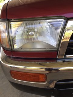

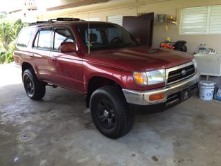

Thanks, habanero! I want to change only the headlamps with the bulbs not the bases. I want to put a 99 headlamps with the bulbs on my 98 bases. Thanks again for your reply.
Well, then nothing I posted is gonna help you, is it? :D You're looking for something like the beginning of an HID retrofit project write-up then (for the taking apart section)?
http://www.toyota-4runner.org/3rd-gen-t4rs/61409-diy-cheap-easy-hid-projector-retrofit.html
If I'm still not getting it I'll cry uncle...haven't even been drinking or anything but my poor old head isn't wrapping around what you're trying to say. :)
habanero, I want to change or replace my 98 headlights with the 99, but since the 99 headlights that I founded have the bases broken I only want to change the headlamps. Based on your reply I now have an idea, but with the write up is much better. Thanks
Ah, that should have made sense since it took me FOREVER to find an intact junkyard set of headlights. Broken bases abound. There may be even better hid write-ups, I just did a super-quick google. Thanks for the clarification.
"If you do not have the complete assembly or like myself located the headlights with damaged buckets, not to worry. You can use the stock OEM buckets from your 96-98 but you will need the rubber boots from the 99-02 so be sure to retrieve them when you get the newer head lights"
Ok, but I tried changing the bulbs and nothing, I like more the 99-2002 headlights. Thanks

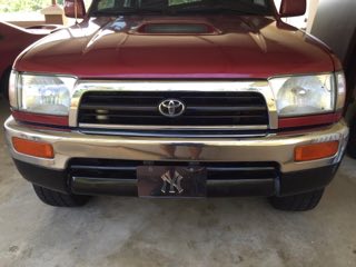

Hi, habanero! I made the change following your reply, first I unhook the spring then take out the clip on the photo marked with green color around and then take out the two nuts (white) with a 10mm wrench. The 99 headlamp fitted well on my 98 bases.
Awesome! Had I thought of that it would have taken a whole lot less time to find a set of newer headlights. Great thinking. :)
Look The 99 headlamp on my 98.
