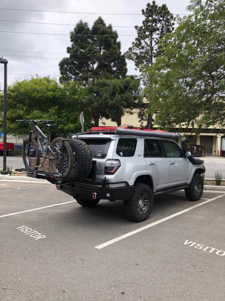

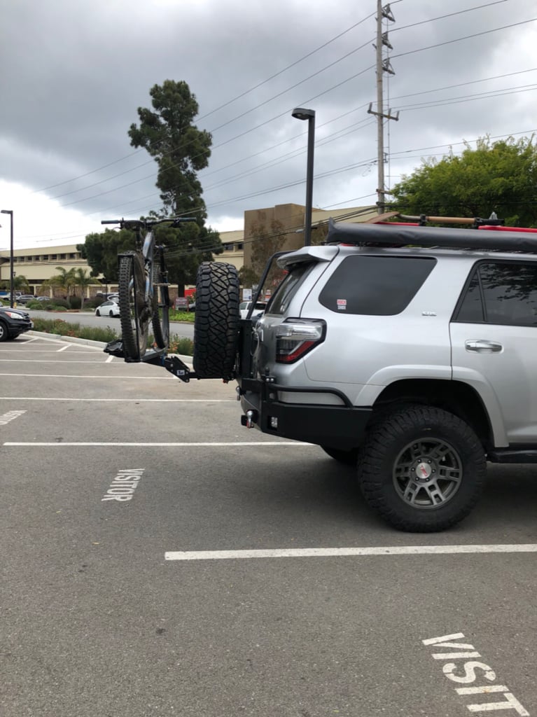

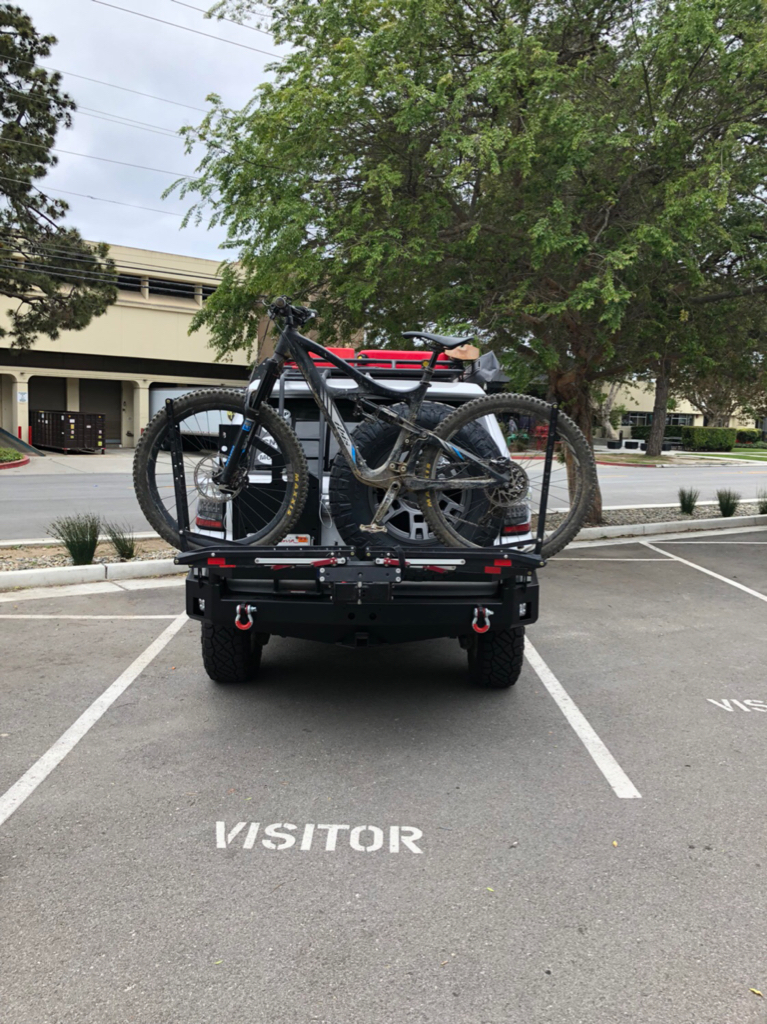

So after years of searching for a setup to transport my mountain bikes on advanced 4x4 trails I think I finally cracked it! 1up heavy duty bike rack + 8” hitch extender + CBI rear bumper with dual swing outs + optional receiver hitch on the tire swing out. Cc: [MENTION=138432]Liquidmantis[/MENTION]
For you MTB nuts that is Santa Cruz Bicycles factory parking lot :P
Maximum departure clearance (With a rack that is)
The best thing about this is that I can swing the bike rack out of the way when camping. Will be testing this setup on the trails of Moab next week!

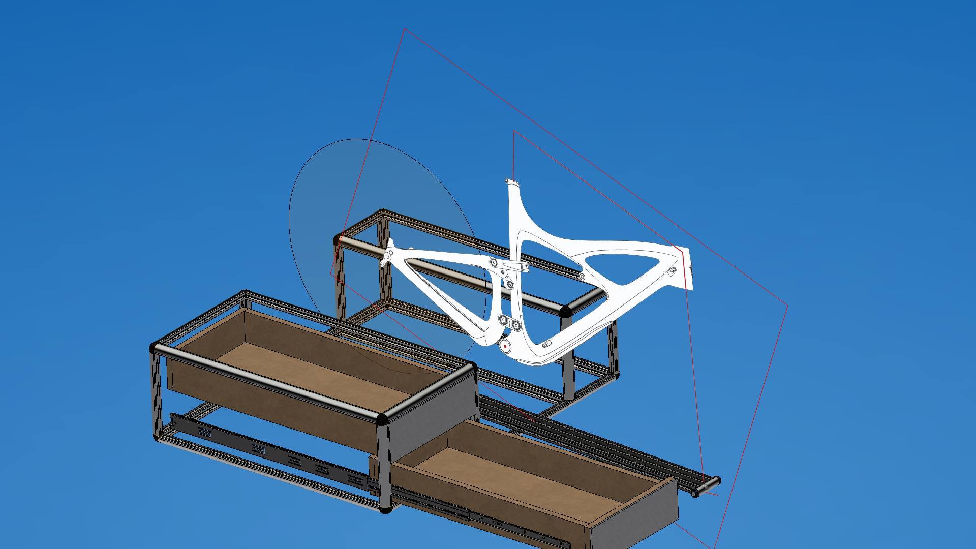

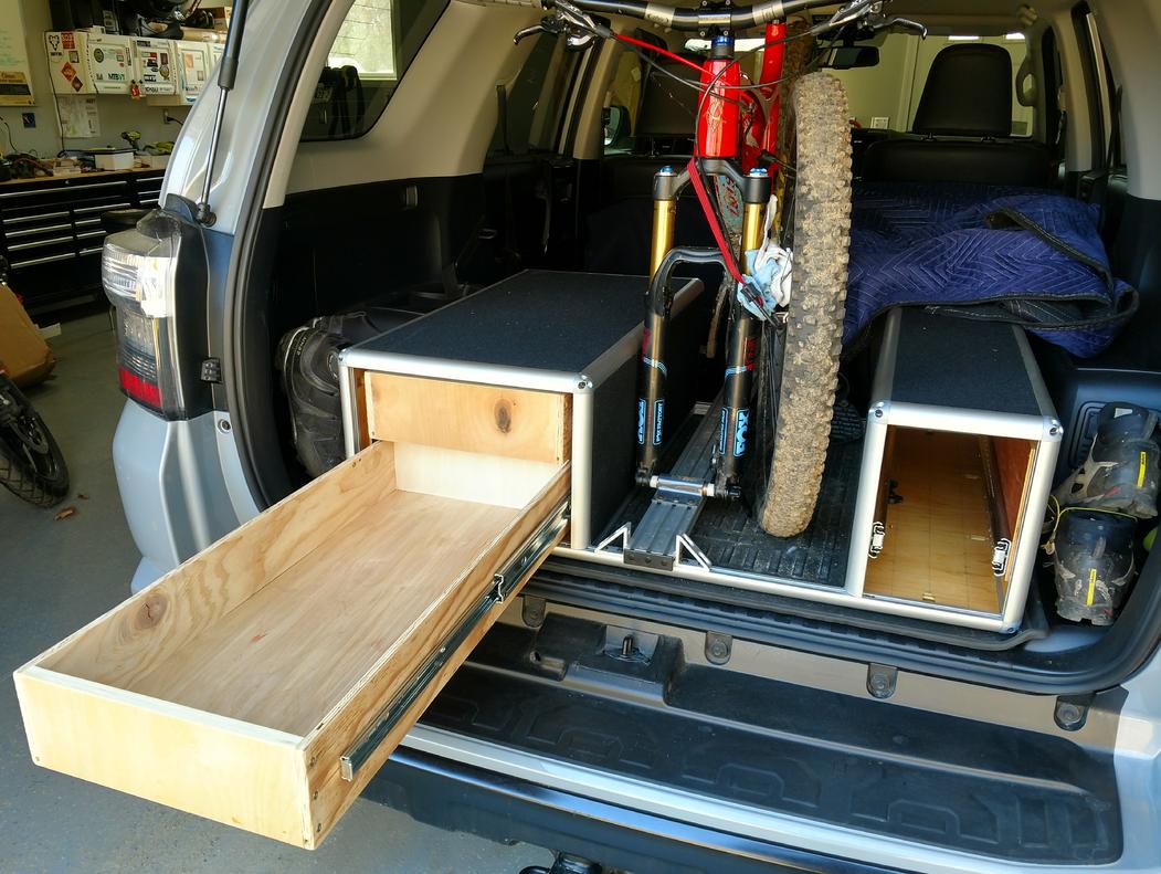

90% of the time I'm just hauling myself and one bike so I've been slowly designing and building up an interior carrier and storage system. Still a work in progress but it's starting to look like something. The drawers are for bike tools and supplies, as well as hiding a small folding work surface. I've got some Rago modular storage panels coming in probably a month or so that I'll also be outfitting to hold bike stuff like shoes, helmets, etc.
The bike tray is my 2nd or 3rd prototype, but I think I'm settling in on an approach I like, and can finally get into CAD/CAM and machining to make a final version. It uses swappable fork tubes much like the Kuat trays - in fact I may just end up having it use Kuat tubes since I already have a full set for all my different bikes.
It's all sized (and the tray will be hinged) so that the rear seats can still be used to haul people.

I’ve seen you parked in the upper lot at Demo. Really nice setup, looks solid!

Seems plenty solid for regular asphalt and dirt roads. The real test is going to be the 100s of miles of rocky trails I plan on doing next week. If it can survive that I think we’re good to go. The potential areas of failure I can see is the latch and spindles. Will report back!
Wow! This is a fantastic solution! Amazing craftsmanship and I love the Mojo 3 ;)
