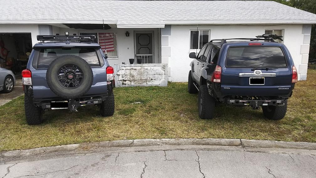

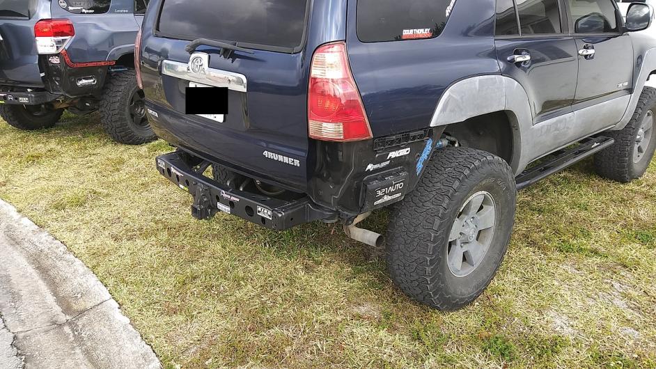

I hate plastic, so my alternative was the quickest, cheapest and the least amount of weight. Probably not much help and the most boring.
