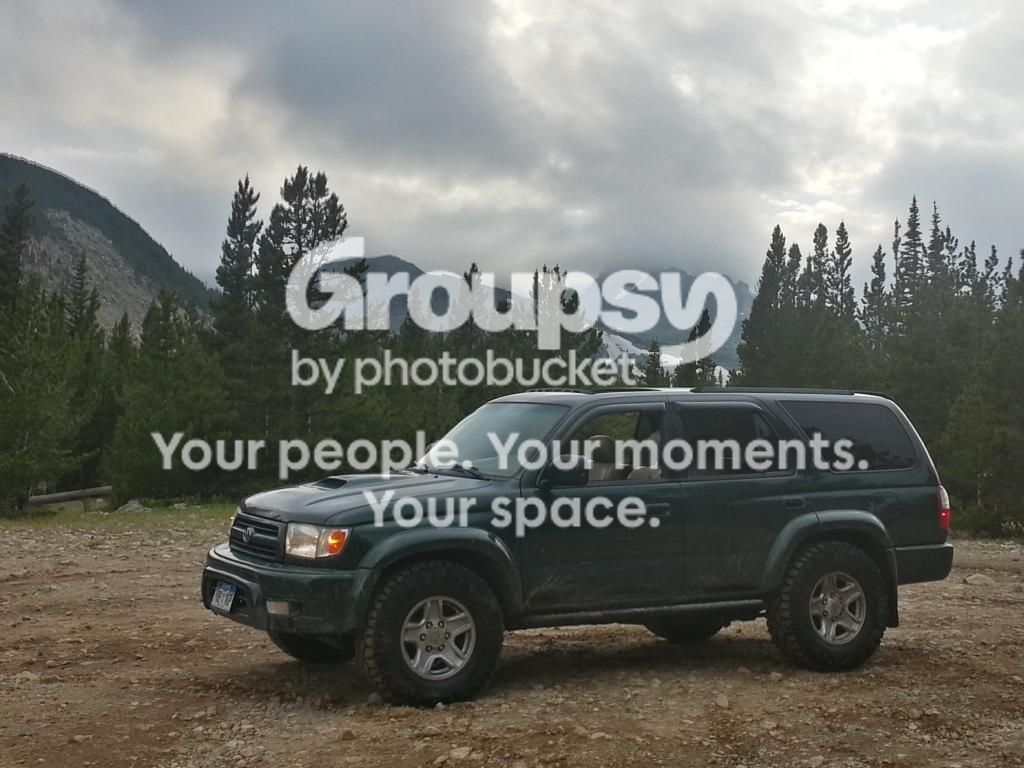

Here's my setup with exactly that.
(From another thread)
MONROE Part # 171351 Struts up front
Highlander springs in the rear
17" wheels from an FJ or TE 4Runner
265/70-17 Duratracs
I would have liked to have put a little more lift under, but I do a lot of long distance driving with it. Where it's at now is a decent compromise between off road capability and highway manners.

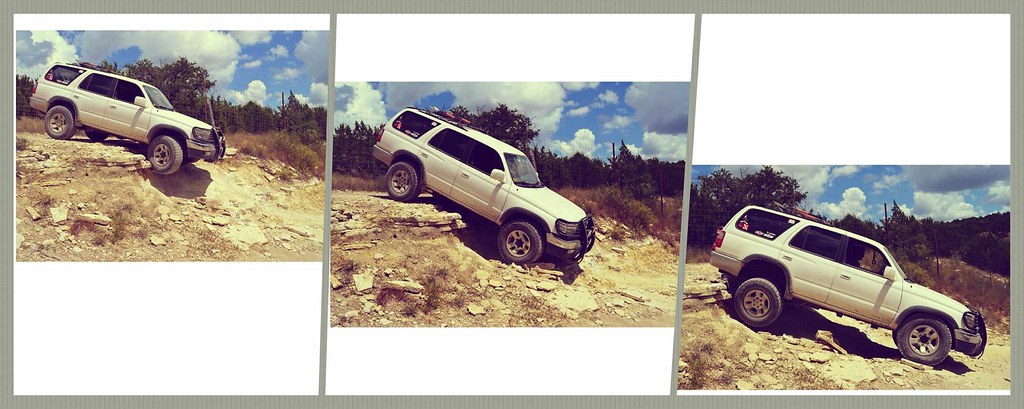

Lifting a rear wheel. Only mod that's not armor was bumping up to a 265/75 Duratrac from the stock 265/70.
20140713_191947.jpg~original
The view at the top was nice, but the terrain is deceiving. What you can't see was massive amount of basketball sized rocks that made up the trail or the water crossing that came up over the hood. The buggy that went before me made it look so easy.
20140713_192441_HDR.jpg~original
